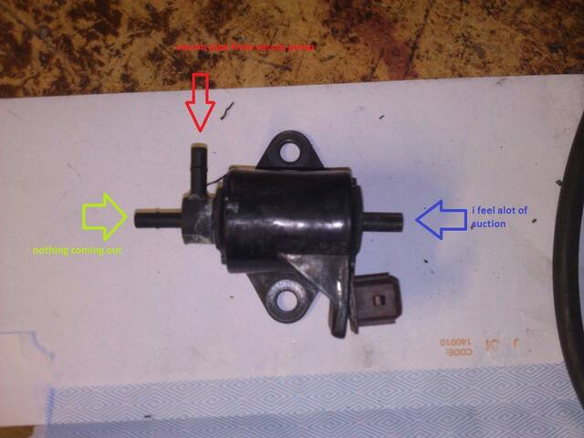

RE: S16 flat - swampy - 27-01-2013 If I had access to it I would copy it to this forum and get it stickied I'm sure some on on here must still have acess S16 flat - Frosty - 27-01-2013 Do you have to be a paid member to access the bible do you know? RE: S16 flat - rocker8742 - 27-01-2013 Ill PM you a copy swampy and you can upload it here if you like RE: S16 flat - swampy - 27-01-2013 I now have the file When I'm on the PC later ill start a thread for some one to sticky S16 flat - Frosty - 27-01-2013 Cheers for the help guys!! RE: S16 flat - Niall - 27-01-2013 My bet is cam timing. Doesnt matter if you used pins. If the job wasnt done the proper method, it can move out slightly! Dont worry about it though. Despite what people say, you can get it a fair way out to the point they will barely run without doing damage. Trust me, im talking from experience thanks to a twat helping me lol. S16 flat - Frosty - 27-01-2013 Well I think it's to do with the avac system. I think it's just me worrying about the cam belt as I did it lol. If I find its not the avac system I will check the cam belt timing Re: S16 flat - aggyj17 - 27-01-2013 Mine had a flat spot turned out to be the solonoid valve bought a new one from pug for £20 iirc been fine ever since One way to tell if the solonoid is faulty it to swap the pipes round . Have you got a major flat spot between 3 and 4 k or 6 and 7k? If you do have either, swap the pipes around if a 3k flat spot moves to 6k and vice versa a new one is required. S16 flat - Frosty - 27-01-2013 Cheers mate. It seems to be flat up to 4k and then it's fine after that. I need to have a play tomorrow Re: S16 flat - aggyj17 - 27-01-2013 This is what the solonoid looks like it is just under the vacum pump. hope this helps mate. S16 flat - Frosty - 27-01-2013 Cheers I will have a look tomorrow RE: S16 flat - James - 28-01-2013 diaphrams should open just about idle then close again at around 5.5k( I think). Obv if they don't open at all then engine feels flat up to 5ish K S16 flat - Frosty - 28-01-2013 Cheers for the info bud! Well I went to check that the pipe sucks when I rev it so went to take the pipe off and me being a little stupid tried to pull it off to hard and snapped the nipple off the diaphragm so I will need to take some off my spare engine now. Hopefully do that tomorrow night. I did notice that when I rev it sometime the diaphragms open and other times they don't. Anyone with any ideas on that? Re: S16 flat - aggyj17 - 28-01-2013 Id say that the solonoid is faulty. |
