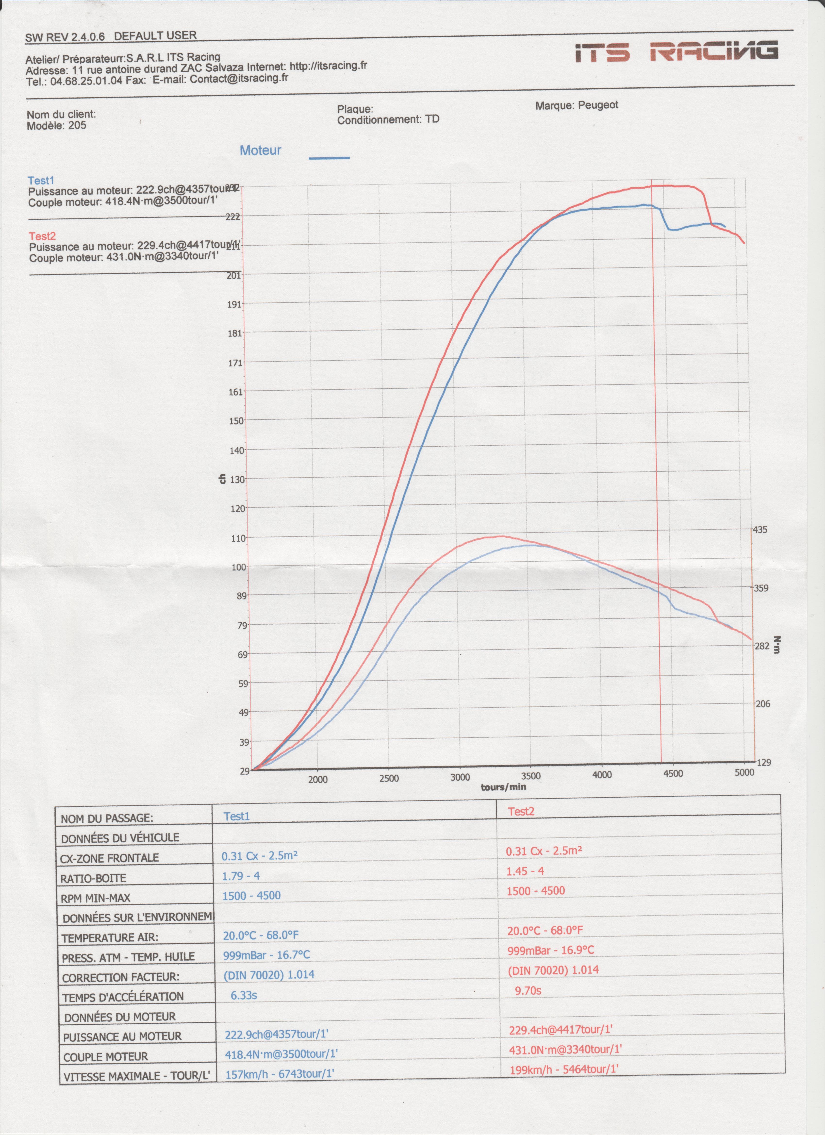

voila passage au banc
205 td 2.1 8s turbo td04l-15t - pompe 11 mm
(28-05-2016, 02:19 PM)niciou Wrote: voila passage au banc
passage au banc : ( pression turbo 30 PSI )
puissance 229.4 cv a 4417 tr/min
couple 431.0 NM  a 3340 tr/min
https://www.youtube.com/watch?v=XmHHOHt3...e=youtu.be
https://www.youtube.com/watch?v=W0aciRaw...e=youtu.be

Bloody el thats a good pull

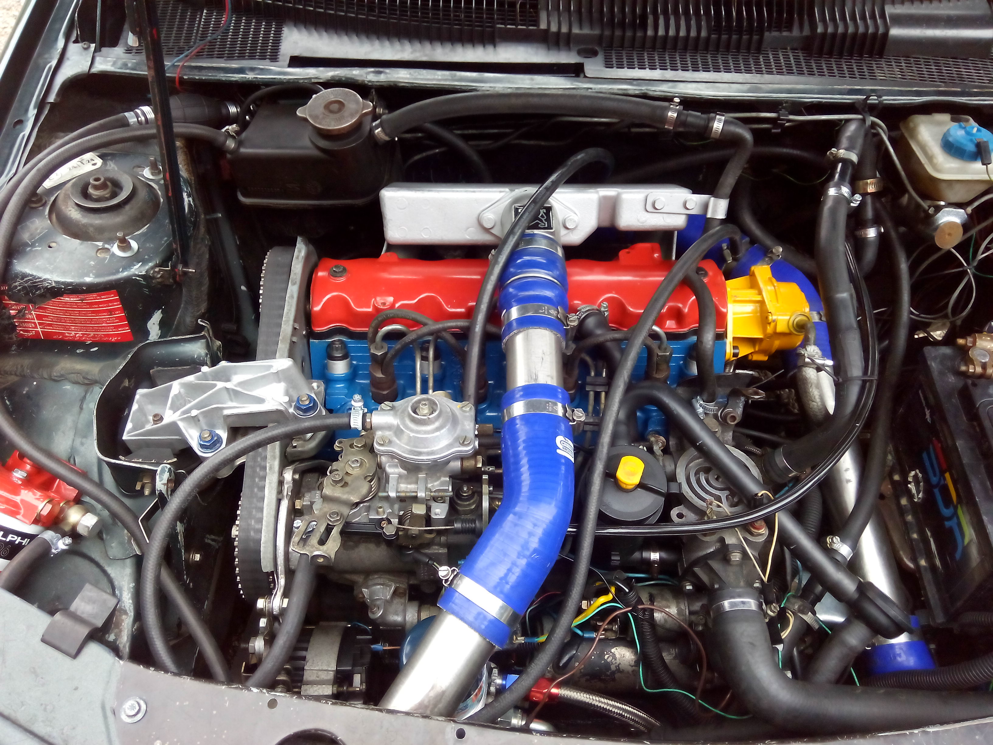

Really impressive. What's been done to that engine?
(28-05-2016, 08:33 PM)399road Wrote: Really impressive. What's been done to that engine?
-culasse 8s with duct intake and exhaust expanded
-block XUD11BTE
-Pump injection 11 mm
- Td04l turbo turbine blades 11 and 15t compressor ( pressure 30 psi)
-line exhaust 60.3 mm
-filter large volume diesel
-Box speed hdi
pump, Lda etc. set by me
5w40 engine oil + MoS2 additive
here I think this may meadows all that I have .
I don not have water for injection and I have not our .
-culasse 8 s avec conduit admission et échappement agrandi
-bloc xud11bte
-pompe injection 11 mm
- turbo td04l turbine 11 blades et compresseur 15t  ( pression 30 psi)
-ligne échappement 60.3 mm
-filtre gasoil gros volume
-boite vitesse hdi
pompe ,lda, etc réglé par moi
huile moteur 5w40 + additif mos2
voila je crois que cet a peut prés tous que j ai  .
je n ai pas d injection d eau et je n ai pas de nos .

Wow well done! Really good results and the engine bay looks tidy too.
(28-05-2016, 09:27 PM)399road Wrote: Wow well done! Really good results and the engine bay looks tidy too.
its been 3 years since I prepared that I try that I rule I have changed the pump compressor several times I went in 19t was 2.3 bar but not its market really well its going .
I have yet to cut small problem when I accelerate its cut and its acceleration can be resumed injectors which are limited to 230 hp .
I'll see if I can not find rods forged to 2.1 td I happened account 260 280 cv later with another turbo 16s and a cylinder head.
but already is not bad I will let stand the wallet Smile
