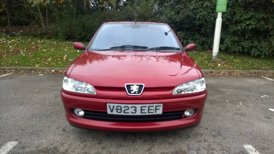

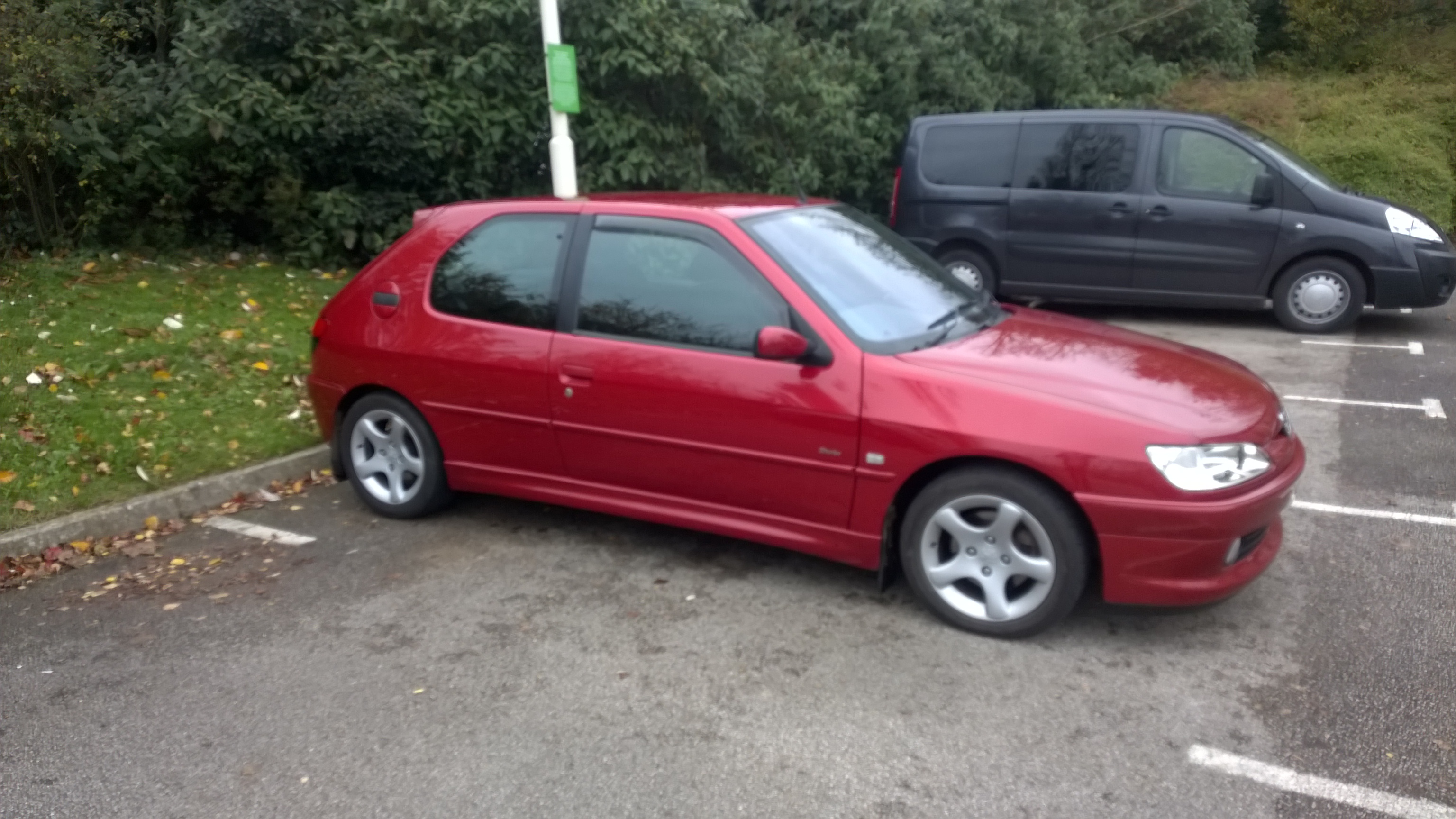

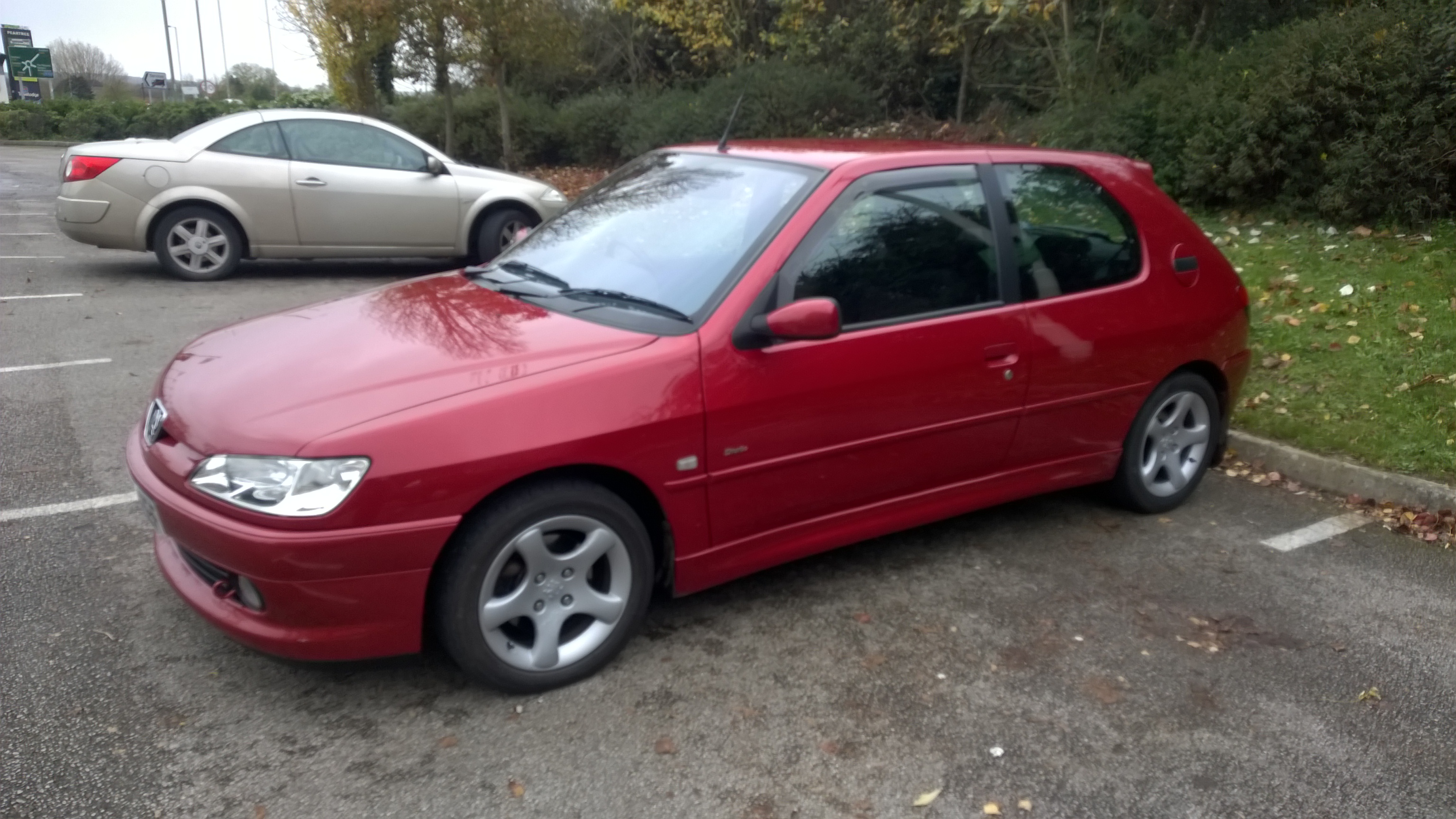

So i've picked up another one.
Pics Smile

Looks clean. Any lacquer peel??
(12-11-2015, 10:06 AM)bashbarnard Wrote: Looks clean. Any lacquer peel??
Nope. Its got a few stone chips on the bonnet but thats about it. Its the cleanest 306 i've seen in a long time Smile
