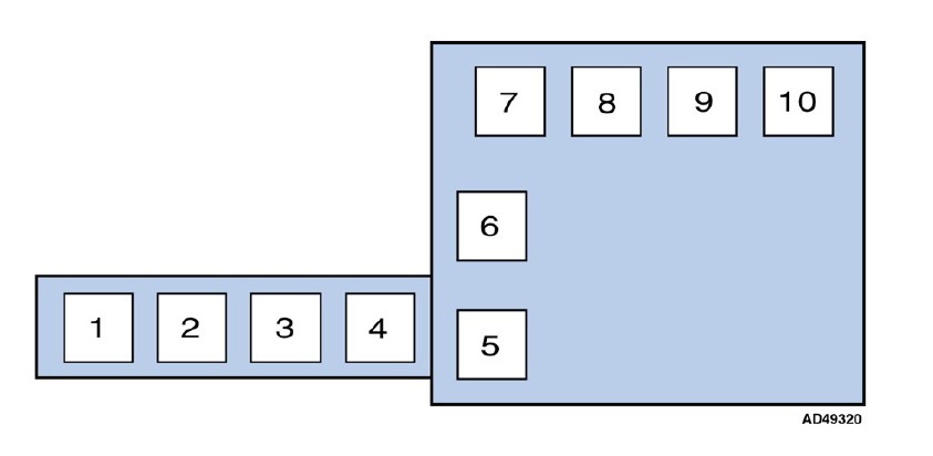

Hi again. These are the relay locations for an early Ph2 XSi. Don't know how similar the phase 1 was & afraid I don't have access to the system it came from anymore. Hopefully the layout is very similar.

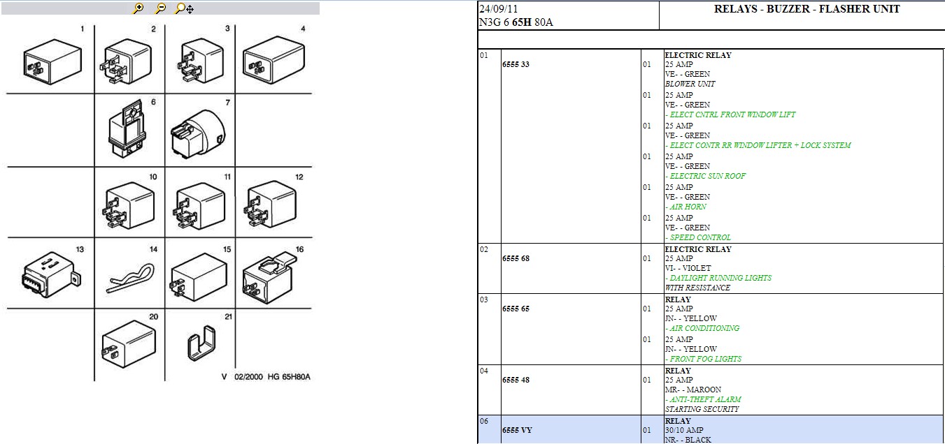

Here is the relevant parts schematic from Servicebox. Looks like you were right that it's the white one, part number 6555.44.
Genius!!! That's not quite right for the Ph1s as the buzzer should be on there (at a guess this had been moved to behind the clocks by this point) but looking at the rest the code seems to be 6555 44 and my 'missing' one, position 4, is for something I don't have so all good!
