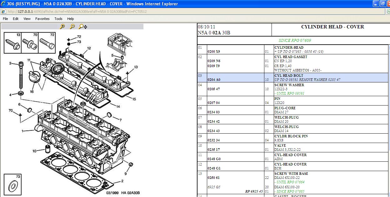

i would also recommend oem gasket, same price as aftermarket and better quality.
belt and water pump from a dealer is under £100, bolts and cam seals etc i would use Payen, significant saving over oem and very good quality.
ed and Steve at warners Tewkesbury are good lads and will often do discount and do post stuff.
the only thing i would have done to the RS head is 3 angle seat cut and valves to match, itll clean up the throat of tge port where the valve seat is, i can post a pic tomorrow of what South wales pistons did on mine (they do very good prices on payen stuff too)
as mentioned the head is very good, Im running about 240 through mine with a standard manifold and head casting.
oh and be very careful with skimming, 0.20 is the max you can take, 137mm is a stock head from memory, if you want to run cams etc you'll be knackered without modified valve cutouts in the pistons.

std head gasket for the RS is 1.2mm thick MLS
if the heads skimmed to the max the J4 engine uses a 1.4mm fibre head gasket as std
Posts: 1,022
Threads: 52
Joined: Apr 2017
Reputation:
4
Location: Bath/Bristol
Car Model/Spec: XSi 16v
Thanks: 3
Given 83 thank(s) in 81 post(s)
Are you sure Cully? I thought the standard fibre gasket for the J4R was 1.2mm and the repair gasket is 1.4mm?
Posts: 7,825
Threads: 465
Joined: Dec 2011
Reputation:
114
Location: Cullompton Devon
Car Model/Spec: Vauxhall
Thanks: 1
Given 98 thank(s) in 92 post(s)
08-10-2017, 11:43 AM
(This post was last modified: 08-10-2017, 11:44 AM by cully.)
yep sorry repair gasket not std
there is no repair gasket listed from peugeot for the RS head @ MLS 1.4mm
there may be others available in 1.4mm MLS but i couldnt find one when i built my engine

citroen list that 1.4mm gasket under the zx for the j4rs engine.
Posts: 7,825
Threads: 465
Joined: Dec 2011
Reputation:
114
Thanks: 1
(08-10-2017, 01:26 PM)welshpug Wrote: citroen list that 1.4mm gasket under the zx for the j4rs engine.
and being a MLS gasket?
good to know if it is
thanks
Posts: 3,539
Threads: 42
Joined: Mar 2012
Reputation:
28
Thanks: 3
Given 89 thank(s) in 88 post(s)
i doubt it is, I did ask how much it was, but went for standard and modified cutouts instead, it was more expensive.

the 1.4 is a repair gasket and fiber
