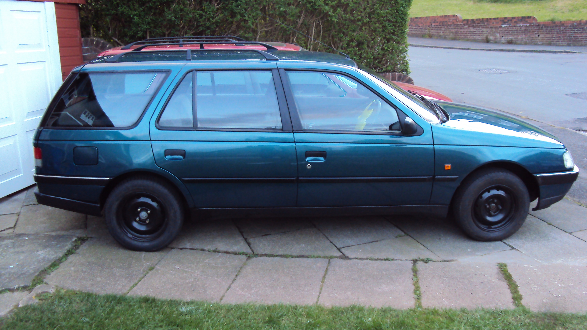

It was a 56000miles from new nad running on 100% waste oil with a bosch NAD pump (which I have still got) hg had started to fail, but didnt brew up...I got a 70000+ mile XUD9TE engine (bosch) out of a breaker 405 saloon with all the s/h and over a period got new and used parts off ebay, mainly LCS Louth who have lots of oem stuff at great prices, been in the scrapyards too...and had the old waxoyl baptism underneath and in the sills. did cam belt and gave bay a good clean, had to mess with one driveshaft as it wasnt a straight swop, new discs pads, rear handbrake cables, complete good s/h exhaust of the wider bore...And from yesterday shes on the road. I have been driving nad 405`s for about 15 years...always wanted a low mileage 405 estate with more power, hard to find at sensible prices...so did it the fun way... I just think the 405 estate is my perfect car....It just looks right and is practical...and has no ecu,dpf,etc...MECHANICAL! And now it has the one missing ingredient...LOL!
First impressions are its plenty fast enough without anything touching...but you know...never say never...
The 405 rolling chassis is the poverty spec "style" so its lighter and a potential "Sleeper"...which are my favourite projects on here....Ive already shocked a tailgating Ford bullying me last night....maybe just needs a tad of coal and boost....

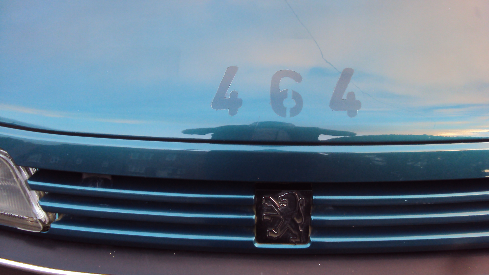

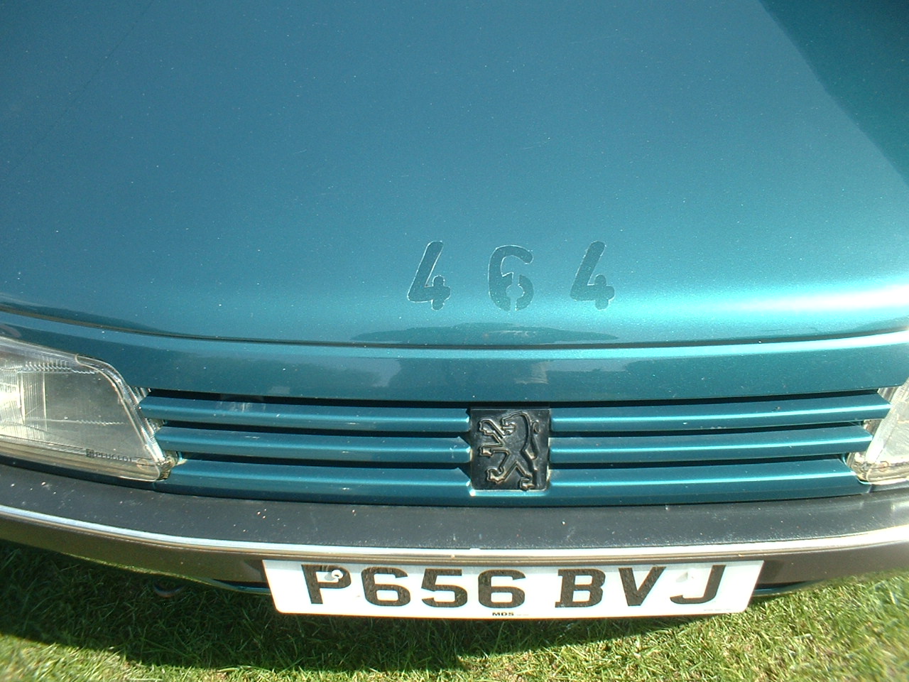

The 464 on bonnet is what I came up with when I burned through the paint trying to buff out a deep scratch with a dremel (FAIL) Paul Baldwin will twig this instantly!
I was wondering about that 464 was about lol

In 1988 the peugeot 405 got 464 votes for the european car of the year...no car in the history of this accolade has ever got as high a vote, before or since...So I like to think its simply the best...better than all the rest...Takes your breath away....(That`ll be the off boost fumes!)

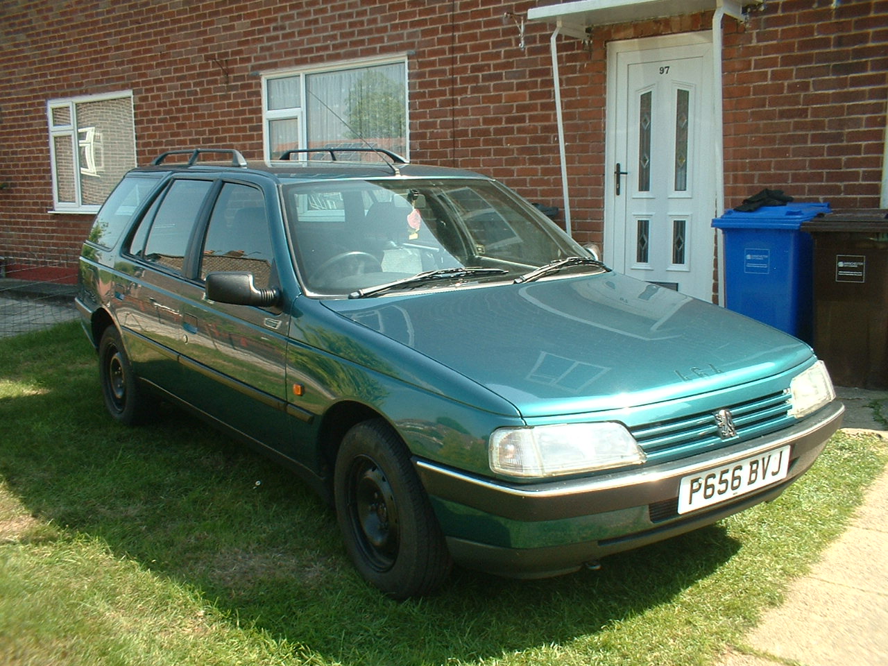

Hi Kevin, if you look at second picture you will see my "spare" 405 nad estate....I found that by shortshifting even that gets along as the torque is quite low down....
Its my Insurance against any Head gasket/cooling issues on the project TD...

Ive spoiled her (the nad)...oil every 5000, oil filter and air  castrol 10w40, just over 80000 miles now and 3 timing belts so far...Im what some would say OCD with service-ing...but the lacquer is just starting to peel a bit and signs of surface rust at the one place they go...rear doors bottom corner of sills...

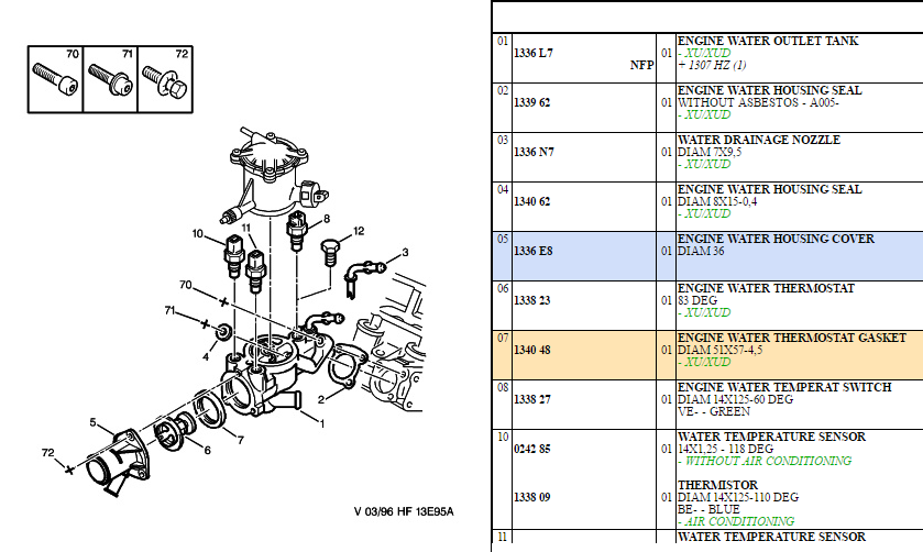

As for the TD well every few days Im checking rad water level as I have a tiny drip on the plastic connector below the diesel filter, light rusty water stain on the starter solenoid gave it away, I wonder if the gasket is available?
Sounds like your thermostat gasket.
i ahev this problem too, I got a new thermostat from eurocarparts but it didnt seal properly so i would say call up Peugeot and get a new thermostat from them which should come with gasket
should be part no 1338 23 i think, im sure someone more knowledgeable can confirm
ECP give you an O ring with a thermostat for the XUD which doesn't seal.
You can buy the actual seal that goes around the outer lip of the thermostat from Peugeot still as i did this on mine.
mr_fish have you a part number please, because the one you describe is the one I need....The last thing I need is coolant level dropping on a TD (ahem! head gaskets)
I have already got some grief with the contact slip ring* under the air bag as it is...
or is it "clock spring*"
1340 48 - £1.72 from Peugeot
Many Thanks indeed!!!
Job Done...put some Bossil Blue RTV on as well!
