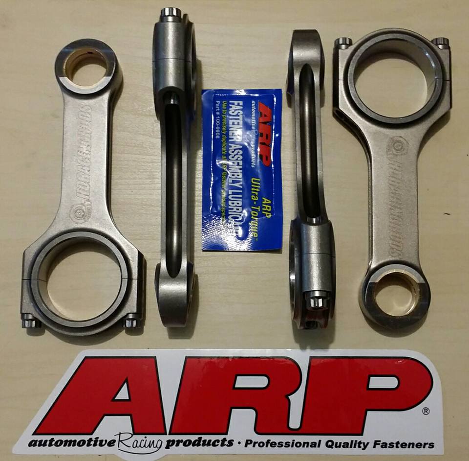

For everyone who needs forged conrods for 1.7 TD, 1.9 TD, 2.1 TD and 2.0 HDI. I sell my own designs on EBAY from France. I ship worldwide! But we can deal directly with a discount. Price is 595€ with ARP L19 Bolts and grease.
Lots of sold for Drag races, and street races. Tested with Methanol, Nos, 3 Bar boost pressure and 6000Rpm. Since 2 years, many engines are running.
Ask for delivery.
Sportively
Biggen
Diesel parts designer:
-HDi/1.9td and 2.1 XUD11T forged HBeam conrods available in stock
-Custom ARP Head Studs kit available for HDi/1.9Td and 2.1 XUD11T
-Aluminium damper pulley for Hdi/Xud11T
-MFS prechamber for XUD
Ask for delivery
