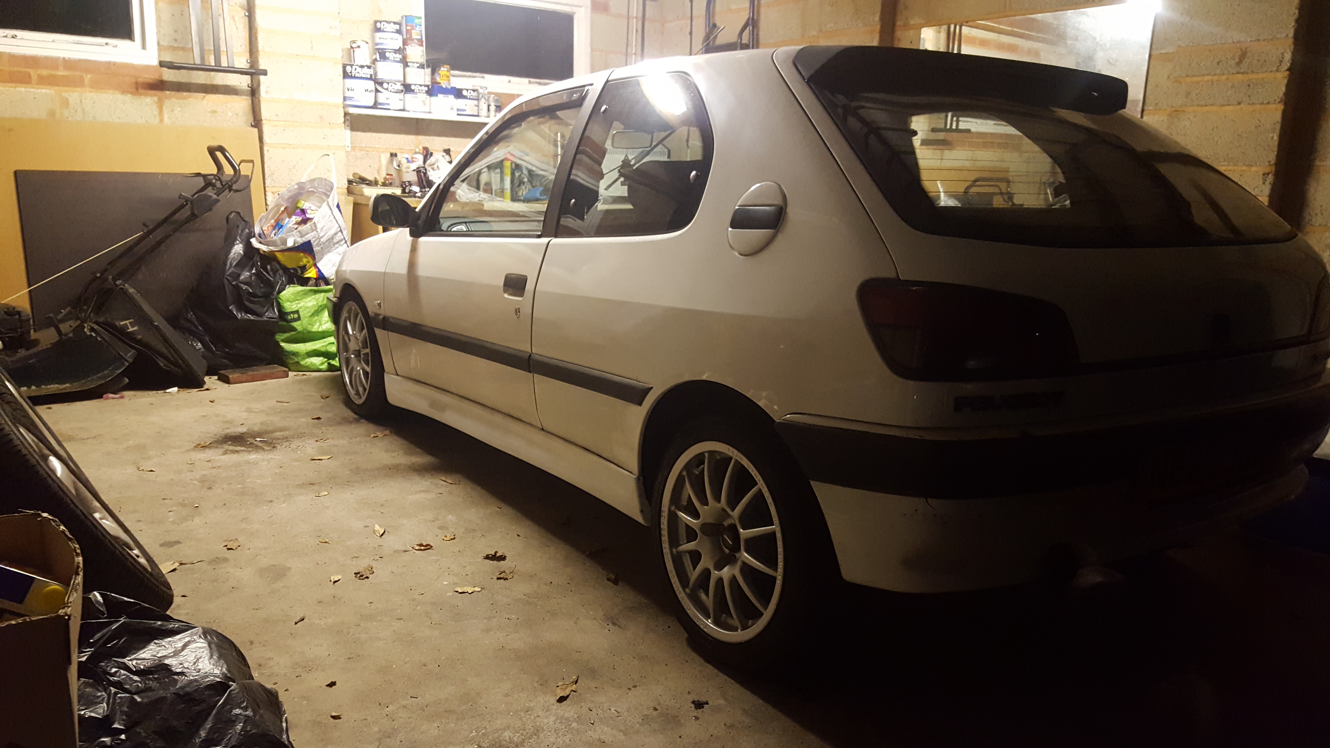

Brought this white ph1. Was a shed! Had horrendous black side skirts.. horrendous black 3 leg spoiler which was tiger sealed on so bad I brought another boot! A bolt has snapped off in the hub aswell.. low on oil as had rocker done (supposedly) and did not top up oil.. saxo vtr wheels.. pretty shit! Also found out it had an engine swap.
Had a new cambelt aux belt. Oil filter oil change. Fuel filter done today. Sprayed ssideskirts white. New boot fitted. Cyclones..got coilovers to fit and disc axle to fit.
Needs a clean.  Boost guage fitted now too.. also ground pin was horrendous to had that sorted.

you're moving in the right direction mate! putting her back in shape, love a bianca phase 1 . . . Smile
Looks great, well done. I much prefer the P1 306's, but very hard to find nowadays. Good luck with the rest of it
Thanks guys. Needs so much love. It's definitely got potential I just feel sorry for what it's been  threw haha.

Wow such a difference thats made! Love a ph1 dturbo in white Big Grin

So .. iv had the cyclones on for 2 minutes and iv already got new shoes for it.. lush 1.2 team dynamics direct for 16"s. Had to buy a new hub as the hub which the bolt was sheered in was completely ruined as someone has tried to have ago at it. Got a cheap hub off frosty!  The coilovers are now fitted but we found out they were 206 coilovers so they don't sit all the way into the hub and was also so tight to get get sit in. Looks much better thoughSmile
