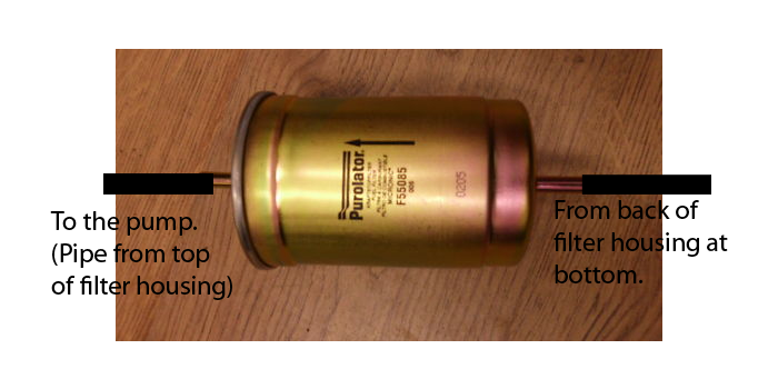

I'm also assuming the arrow on the inline filter, is the direction of fuel flow :roll:
and basically, the inline filter takes the place of the stock, like so, this expert drawing should explain
[Image: 69k5H.png]
#58
Quote:I'm also assuming the arrow on the inline filter, is the direction of fuel flow
Should answer...
Simple as you can get below and it would be fine. Smile
[attachment=0]

#59
yeh, you're picture wins lol legend, thanks a lot!!
should hopefully remove the slugg i get at top rpm, tends to just "stop" when high fueling, from what i've read, it could be caused by bubbles forming in filter housing - as im running veg.
