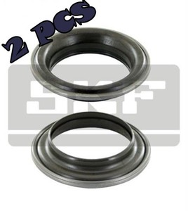

Chris - just checking, did you put the top mount bearings in the right way round?

(10-04-2014, 11:49 AM)Toms306 Wrote: Chris - just checking, did you put the top mount bearings in the right way round?
Don't say this.
Remind me what the right way up is please. I need to put the shock boot on the drivers side anyway as we missed it reassembling the strut.
[Image: Sig500x130.png]
Fat side into the mount, pointy side down.
Top one in this pic is correct way.
[Image: %24T2eC16Z,!)kE9s4,BEDtBQ8ymIyvZ!~~60_35.JPG]
Yeah i noticed though that when i bought my new ones from ECP the bearings were in the mounts the wrong way round, i guess it just made them fit in the box better, but that could be confusing as some people would think that if they come in the box that way, that must be the way they go.
A little while back i had a few snags with the car, and it turned out that a garage had put one of the top mount bearings back in upside down when they replace my springs, they were not new ones they reused the old ones, and this is what happened to it after a little while.
[Image: IMAG0961_zps1878fd96.jpg]
Yep, it saves packaging....and yes its not uncommon for people to fit them that way round lol.
