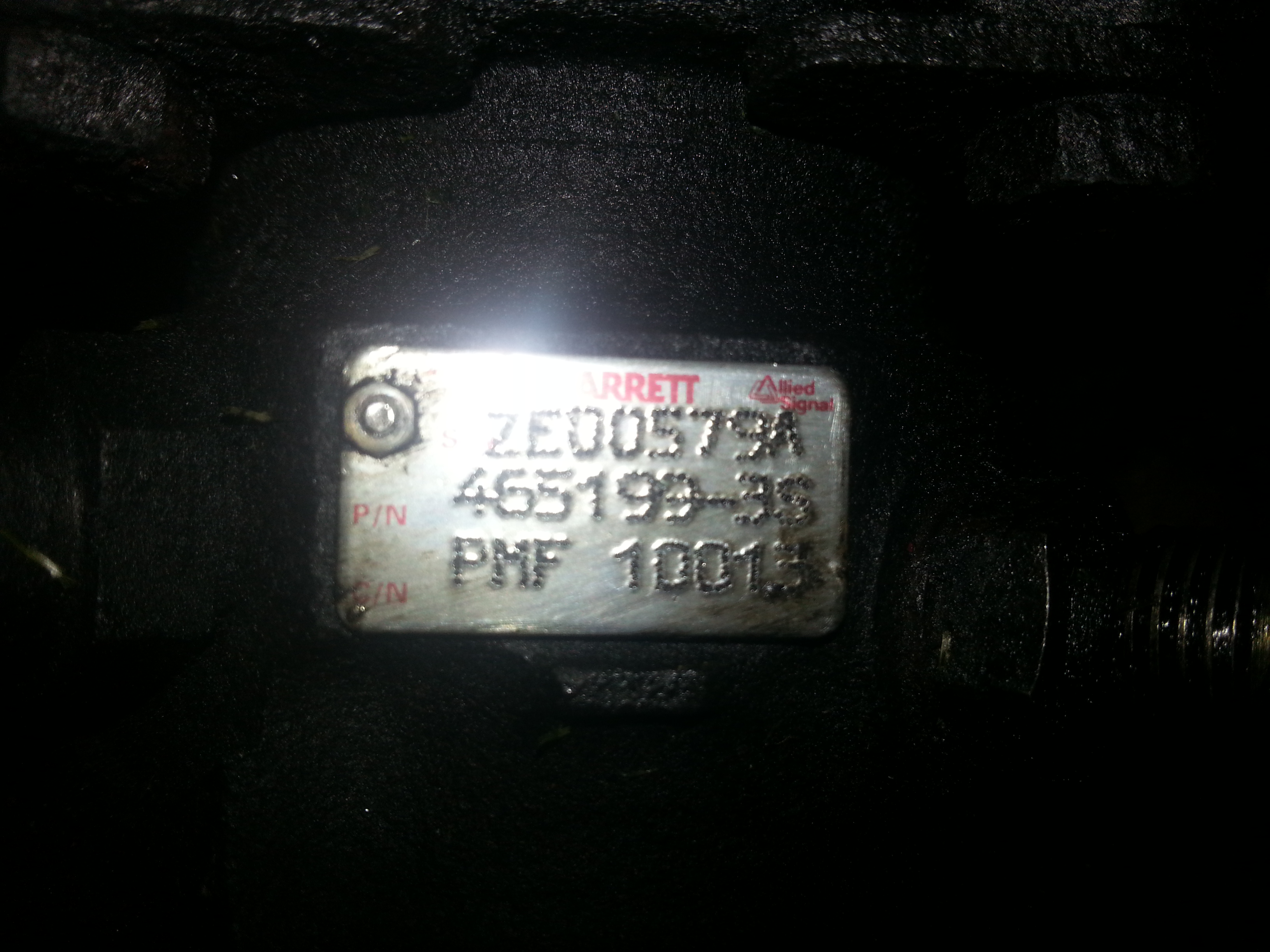

Ive got a t25 welded to an xud manifold. It smokes real bad and chucks oil out the exhaust. What rebuild kit do i need. Heard about 360 bearings buf not clued up on turbos any help much apprciated.
