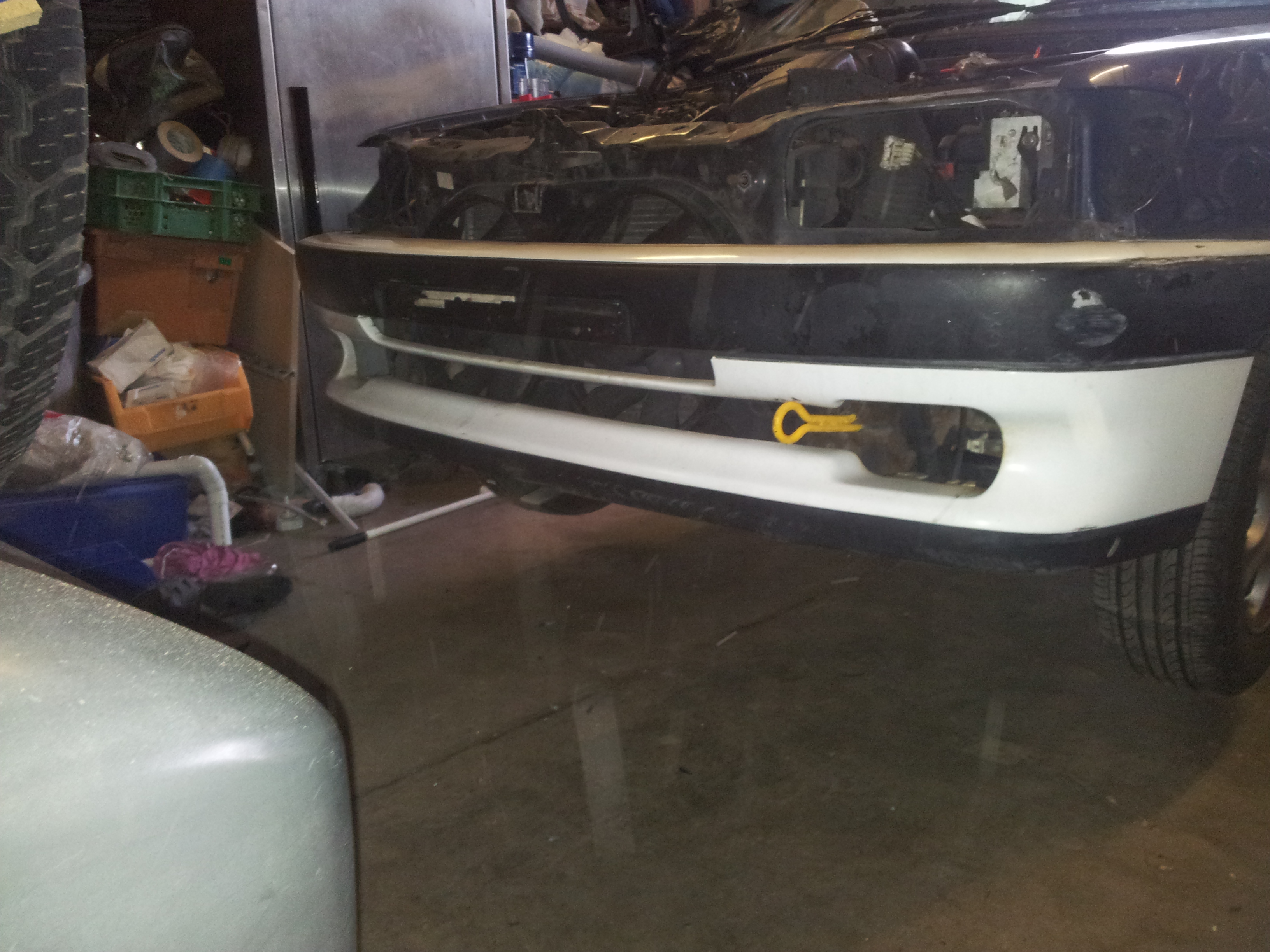

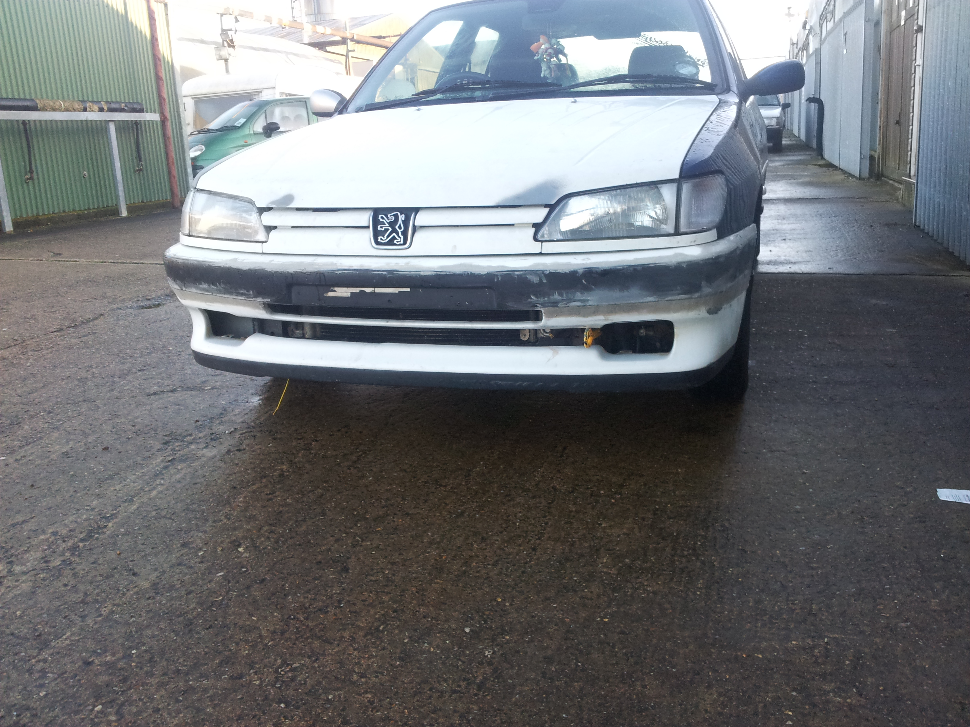

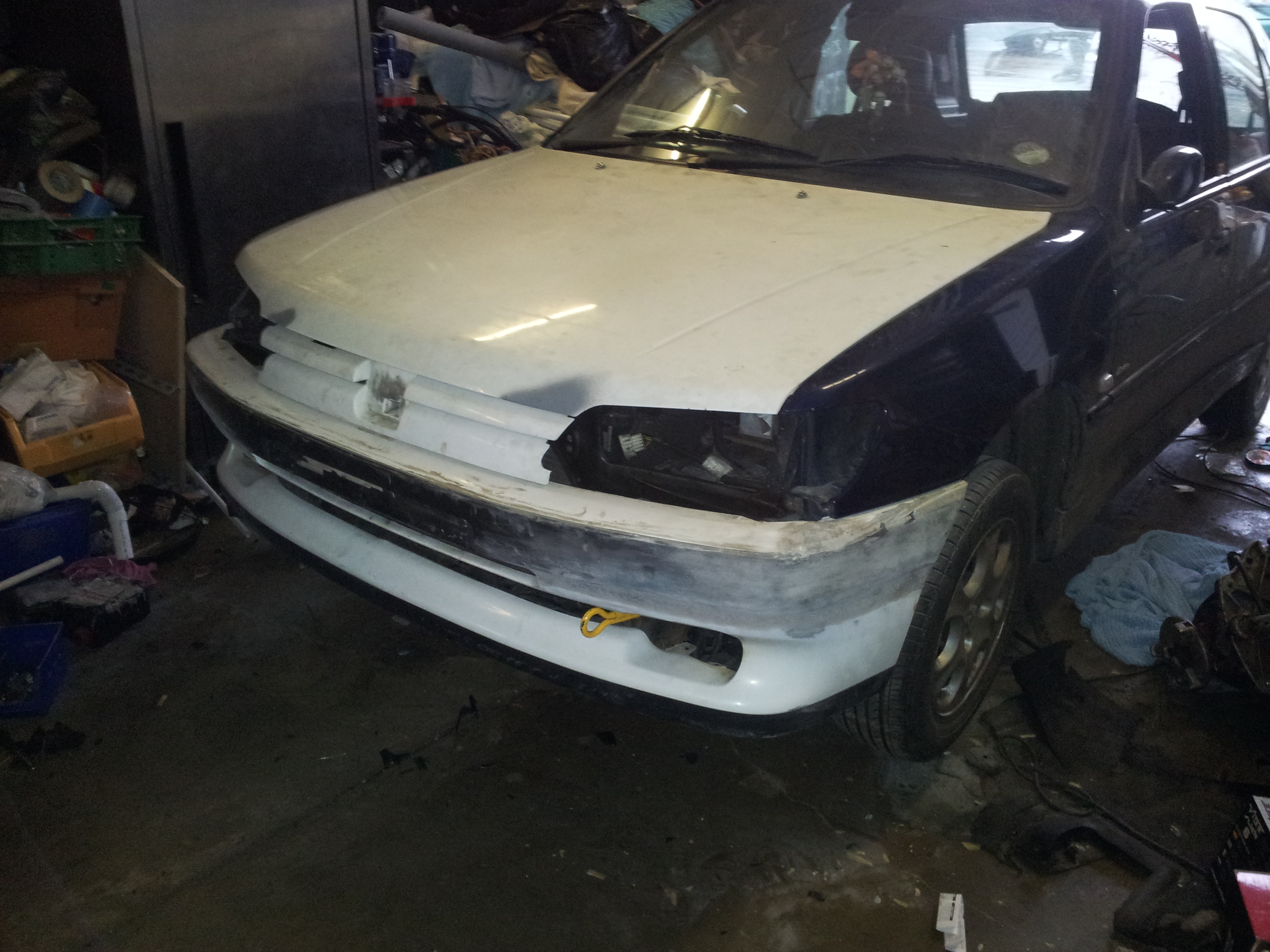

RE: phase 3 downlift - identitidrjekyll - 24-11-2012 Thanks :-) RE: phase 3 downlift - zoemilly - 28-11-2012 what are you planning to do with your 3 front end? as im looking to facelift my 2... RE: phase 3 downlift - identitidrjekyll - 29-11-2012 Sell but i started smoothing the front bumper and never finished it RE: phase 3 downlift - devils_fuel - 25-03-2013 any pics of this conversion? RE: phase 3 downlift - identitidrjekyll - 25-03-2013 Yeah been a while since i did any work because of the weather in norfolk, got all the parts but only managed to put the front end on, looks like a shed atm but gonna paint it once its all done This was a mock of the bumper on the old slam panel to test if i could use the phase 3 slam pan, unfortunatley you cant because of the headlights and bonnet latch Picture of bonnet and grille on With having to use a phase 1 slam panel it then ment i had to weld the bracket for the phase 3 expansion bottle to the slam panel and had to ziptie the rad(this is being ditched this weekend for a phase 1 dturbo rad with the built in bottle) This is what it looked liked after ( ignore the smoothed bumper as thats going, just after this pic it snowed and like a novice i crashed and buggered the bumper up, got a new one waiting to go on again this weekend, wings also need to be changed as there still ph3 and thetes a nadty headlight gap) After this i decided to work on the cars handerling. Blistein b4 shocks and spax 40mm springs 205 1.9gti alloys, £42.50 ebay bargin! And an omp strut brace (had to bend the ecu plate to fit it and raise the phase 1 bonnet) RE: phase 3 downlift - devils_fuel - 25-03-2013 Ooh ph1, I like a nice ph1 but they are so old and tired nowadays unless you have deep pockets lol RE: phase 3 downlift - identitidrjekyll - 25-03-2013 Car now sits like this (before bonnet raise and strut brace) Fitted a tiny 280mm steering wheel to be a tart And gti 6 headrest as i hate meridian ones Sorry ive been short and sweet as the misses is waiting to watch a film, its getting there but still have alot to do :-\ To do list: Ph 1 wings Ph1 boot Ph1 rear lights New rad setup 307 hdi injectors (mine rattle again!) Fmic Remap Respray!!!!! Lol my pockets are deep ;-) this is more a labour of love Also ph3 shell is galvanised so no rot! RE: phase 3 downlift - ozonehostile - 25-03-2013 phase 1 hdi is something ive been waiting for someone to do you going the whole hog and going phase 1 rear light clusters too? RE: phase 3 downlift - identitidrjekyll - 25-03-2013 In my todo list above bud RE: phase 3 downlift - ozonehostile - 25-03-2013 you should get it resprayed in moonstone blue, a color phase 1 never came in but would give people who know anything about 306's a clue that it might be an hdi (apart from the number plate obviously) RE: phase 3 downlift - identitidrjekyll - 25-03-2013 Belive they didnt come in china blue, it was nile blue, might put the hdi badges back on RE: phase 3 downlift - ozonehostile - 25-03-2013 oh yeah, good point lol. really like this idea in general though
