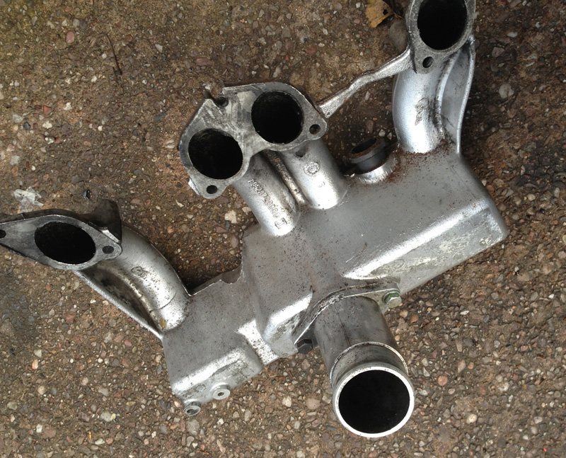

RE: New to French cars and diesels - londondan86 - 02-08-2013 Welcome to the club! Lots of info on here regarding derv tuning! For the fmic you will need an inlet adapter something like this Or a xantia manifold like this: I would walk before you run though, get a bosch on there and do a good stage 1 before you look at front mounts and 11mm's but I like the enthusiasm!! lol RE: New to French cars and diesels - Grant - 02-08-2013 Welcome along, you are certainly in the right place for the help you are looking for! RE: New to French cars and diesels - Scott - 02-08-2013 Welcome to the club! Done very useful info there from Dan

RE: New to French cars and diesels - kingy - 02-08-2013 Welcome along mate. I'll leave the derv advice to others as I know naff all about them really. RE: New to French cars and diesels - simonh - 03-08-2013 Thanks for the info. I didn't want to come on and just ask all the questions that are covered elsewhere. Xantia manifold looks like a better option. After a few goes at the pump it's peaking and holding 1.7 bar of boost and it seems to be possible to drive round the smoke problems ( lighter throttle until 0.5 bar of boost then full throttle and just never let it labour in any gear) Goes really well in the morning or late at night when it's cool but obviously far too high inlet temps during the day and it just doesn't seem as keen. Should probably turn it back a bit but all temps and boost pressures can be controlled by the accelerator pedal. That was why I thought intercooler before Bosch. It looks like a much simpler and cheaper option to me but that may just be because I tend to avoid mechanical stuff where possible. Does a standard Bosch pump on its own make the biggest difference when it comes to getting power out one of these? It looks like I just need a standard Bosch pump with a few mods, definitely no need for an 11mm pump (now that I know what one is!) Have a set of Gti-6 wheels to tidy up and fit although really liking the surprise factor with the wheeltrims. RE: New to French cars and diesels - Danny2009 - 03-08-2013 A Bosch is a must if you want to tune it so much more to play with to get the power just better pumps RE: New to French cars and diesels - simonh - 05-08-2013 Need to get a few more post up so I can actually start buying stuff from the for sale section! RE: New to French cars and diesels - Dum-Dum - 05-08-2013 Welcome to the club, there's loads of REALLY good info in the diesel section and the guides so this is the place to be. Sedans are awesome but people always crash into me when I won them so I have a slammed estate. The white 2.1TD converted one (see project section) is the last sedan i built. A bosch might not make you alot more poewr untill its got internal mods but it does have alot better smoke control and also will run on cooking oil (which is about half the price of diesel). FMIC and bosch are the way forward till you read enough guides here to be confident to build a 10/11mm pump and fit a bigger turbo. RE: New to French cars and diesels - simonh - 05-08-2013 FAO Jake: I'm really interested in your wheels. Is there any chance you could contact me on simonharkness@yahoo.com please. Hope this isn't violating forum rules. Re: RE: New to French cars and diesels - Jake - 05-08-2013 (05-08-2013, 11:33 AM)simonh Wrote: FAO Jake: I'm really interested in your wheels. Is there any chance you could contact me on simonharkness@yahoo.com please. Hope this isn't violating forum rules. Pm sent RE: New to French cars and diesels - Niall - 05-08-2013 (05-08-2013, 11:43 AM)Jake Wrote:(05-08-2013, 11:33 AM)simonh Wrote: FAO Jake: I'm really interested in your wheels. Is there any chance you could contact me on simonharkness@yahoo.com please. Hope this isn't violating forum rules. He wont be able to read your PM mate! RE: New to French cars and diesels - simonh - 05-08-2013 Thanks Jake, money should be on its way to you. RE: New to French cars and diesels - simonh - 05-08-2013 Job done. Just four posts to go and I should be able to buy the Bosch setup that's in the for sale section. What's a sensible price to offer for it? Re: RE: New to French cars and diesels - Jake - 05-08-2013 (05-08-2013, 01:20 PM)Niall Wrote:(05-08-2013, 11:43 AM)Jake Wrote:(05-08-2013, 11:33 AM)simonh Wrote: FAO Jake: I'm really interested in your wheels. Is there any chance you could contact me on simonharkness@yahoo.com please. Hope this isn't violating forum rules. It's all good I sent directly to his email. (05-08-2013, 03:00 PM)simonh Wrote: Job done. Just four posts to go and I should be able to buy the Bosch setup that's in the for sale section. What's a sensible price to offer for it? I'd say £120 with all lines and injectors. Tis what I sold mine for! RE: New to French cars and diesels - Tom - 05-08-2013 A new guy that is researching first and asking questions later! Finally the world is learning to internet! Welcome along mate, you will fit in just fine here

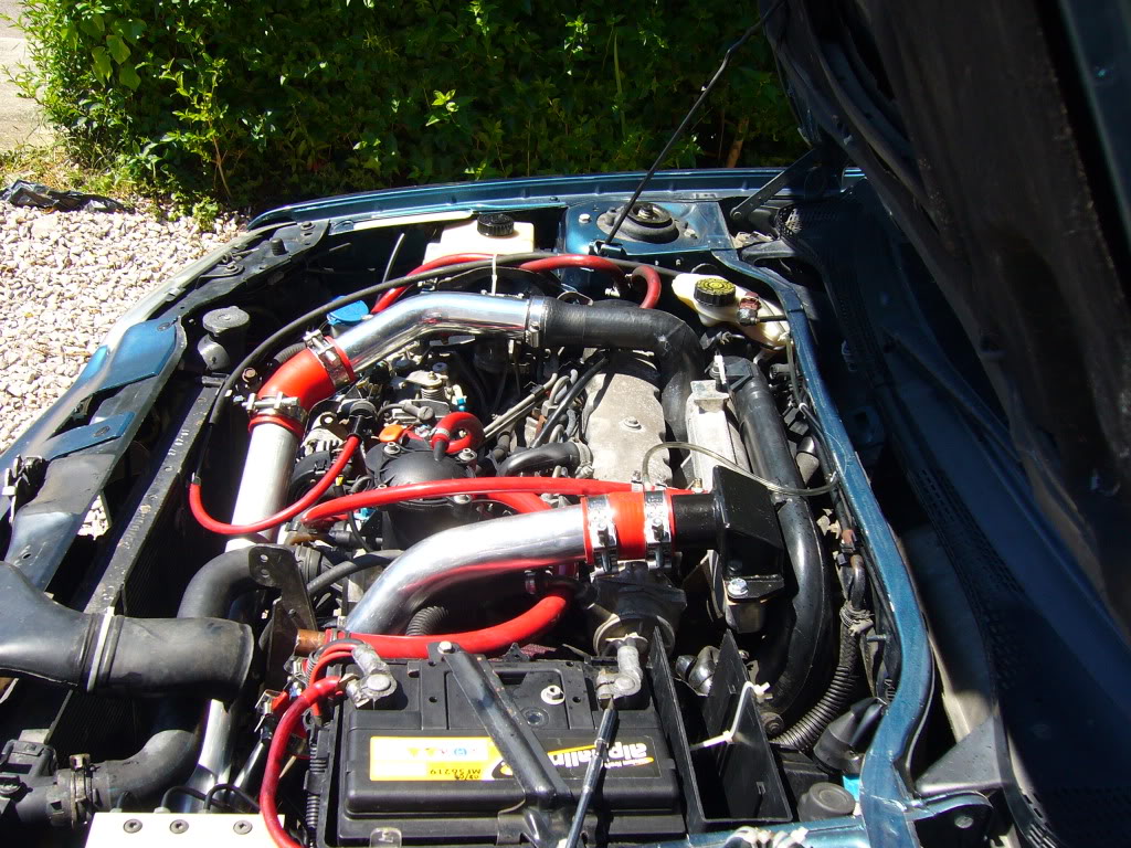

RE: New to French cars and diesels - ozonehostile - 08-08-2013 sedan ftw RE: New to French cars and diesels - Jake - 08-08-2013 Need some pictures of the car man! RE: New to French cars and diesels - simonh - 09-08-2013 Not the greatest pictures but here you go: ![]() ![]() ![]() ![]() After suspension calculations went a bit wrong ![]() How it looked last night after getting rear set. Bit fuzzy as was starting to get dark.
