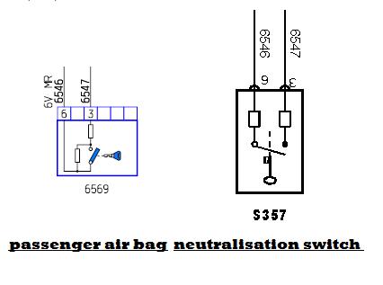

can someone check a switch please - 3gan - 23-03-2013 can someone check something for me please? airbag on off switch does this open and close a circuit or just change resistance? I believe my airbag on and off switch is faulty even tho I bought one from eBay it still gives the same error codes can I ask your views please if I run test through the switches with my multi check the light illuminates whether the switches are on or off do you know if the switch should not give the same result if in the off position? my fault codes read today were p1862 of the passengers airbag deactivation not defined and p106f passenger airbag deactivation undefined RE: can someone check a switch please - cully - 23-03-2013 peugeot wiring drawing shows it as a change of resistance BUT Autodata shows it as an open close resistance switch with the switch in the off position it will light a picture lamp on the dash showing pas airbag disables RE: can someone check a switch please - 3gan - 23-03-2013 many thanks for your help buddy yes that is exactly what I have on the dash airbag light this is the only thing I tampered with when I changed a steering wheel I did move the squib slightly but I have no faults for that I got another switch off eBay and both switches make no difference in the on position we are unable to clear those codes using a snap on solus code reader and remover very possible both switches are not functioning correctly any ideas? on the above fault codes buddy I believe it should be open or closed personally RE: can someone check a switch please - cully - 23-03-2013 you dont need to clear the codes! once you fix the faults the ecu clears itself unless its been activated "Boom" no idea on the fault codes PP2000 is the best to read the airbag ECU ![]() P1862 Transmission transfer case contact plate power circuit failure P106f ??? could convert too P1111 P1111 Intake air temperature (IAT) sensor circuit Intermittent high voltage RE: can someone check a switch please - 3gan - 23-03-2013 thank you I still believe I need a new switch as a starter as it's all I can remember touching ill get a price for one Monday and keep you guys posted as it must be one of those faults that lots of people get over time :-( RE: can someone check a switch please - cully - 23-03-2013 most of the time the faults on the airbag system is related to the plugs under the seats RE: can someone check a switch please - Eeyore - 23-03-2013 this had made me realise that my airbag light may be on because ive turned the passenger one off when changing steering wheel and never turned it off.... does it constantly illuminate the normal icon? or is there another icon? RE: can someone check a switch please - cully - 23-03-2013 yes lights the air bag light i believe will check when i get my car home again sometime next week RE: can someone check a switch please - 3gan - 23-03-2013 SRowell that is exactly what I did turned the passenger bag of whilst changing the steering wheel just to be safe ever since air bag light is constantly illuminated I have tried everything ugs under the seats are fine I even soldered the earth plugs I believe the airbag pass switches are faulty what are your thoughts? I am pretty close to dropping it off at peugeot ![]() RE: can someone check a switch please - Eeyore - 23-03-2013 i wouldnt drop it off at peugeot D: if its only the airbag light staying on thats the least of peoples worries normally! RE: can someone check a switch please - 3gan - 23-03-2013 it is now an mot failure from this week onwards buddy mot testers will be wanting to see airbag lights light up and go out after a few seconds or once the engine has started so there will be an influx of cheap cars available soon with airbag faults :-( I just wish mine was straight forward RE: can someone check a switch please - 3gan - 25-03-2013 ok I have spoken to three independent mechanics today and I know what is wrong I will post up once fixed and when I am totally sure but from how they have explained things then it all makes sense :-) RE: can someone check a switch please - cully - 25-03-2013 not to us it dont please explain RE: can someone check a switch please - 3gan - 26-03-2013 once ecu has logged a live feed giving a solid light the airbag ecu has to be wiped or swapped but if buying second hand you need to match serial numbers up then it's fixed ![]() getting rid of a solid light by taking the battery off is unheard of and if this does work it must have been a very minor fault RE: can someone check a switch please - cully - 26-03-2013 i dont understand what you have just tryed to explain! i can force a solid light on my airbag system buy unplugging a bag! once i reconnect, the system self checks and resets to OK state RE: can someone check a switch please - Tom - 26-03-2013 Well that made no sense, those mechanics dont seem to understand the system atall :/ RE: can someone check a switch please - 3gan - 27-03-2013 well I have been told because I switched the ignition on without reconnecting the steering wheel airbag it has logged that fault which is specific to me and probably different to other people's experiences I am waiting on the ecu to arrive and will post up more I can only go on advice I have been given I am also hearing the same resolve from other mechanics we have checked everything available and unable to find another fault to fix hence why I said I would post up once tried and tested but was asked to explain beforehand RE: can someone check a switch please - 3gan - 27-03-2013 well tried with another airbag ecu no different I must have somehow done something else wrong here totally confused and if course gutted! bugger :-( RE: can someone check a switch please - 3gan - 27-03-2013 I looked behind the stereo just now I can remember fixing a pulled wire so have just taken a pic it's an orange wire than plugs into the USO black connector block on the rear if the radio anyone know what that wire would be for ? just thinking prior to me having this car someone could have linked this one up and caused a problem? just clutching at straws before its booked in at peugeot ;-( RE: can someone check a switch please - cully - 27-03-2013 is there any numbers on the wire? look for printed numbers between stars on the wire itself orange wire is posably the illumination wire for lights on on the stereo RE: can someone check a switch please - 3gan - 27-03-2013 just checked the wire out and it's an earth I may have stumbled on something behind the stereo there is a brown plug clipped to the bulkhead? it has no connector to it? I can't see anything loose but anyone know what this one maybe for please peeps many thanks for your help RE: can someone check a switch please - cully - 27-03-2013 what car and spec have you got as there are loads of unused plugs in most 306's RE: can someone check a switch please - 3gan - 27-03-2013 peugeot 306 hdi 2001 model I took pic can I post it on here? RE: can someone check a switch please - cully - 27-03-2013 have a fish around and see if you can find another brown plug that fits it RE: can someone check a switch please - 3gan - 27-03-2013 believe me I removed the whole centre fascia switches radio etc had my hands all around looking and feeling about could not feel or see anything when I got out of the car the beeper sounded as the lights were on part of the rev counter section started flashing like there was a bad connection on the back of the dash cluster would be good to try my cluster in another car my cluster may be faulty or the plug damaged etc if I hit the dash with the lights on then there is a small section from say 1000rpm to 3000rpm that flashes so Definately a bad connection causing that considering my seatbelt warning light and side airbag either I wonder if I may have found a problem :-( RE: can someone check a switch please - cully - 27-03-2013 duff lamps will flash if you bash the dash RE: can someone check a switch please - 3gan - 27-03-2013 I did remove the cluster on two occasions to do a complete check and renew of bulbs wishing now I had not bothered :-( RE: can someone check a switch please - 3gan - 28-03-2013 anyone know what the plug is for in the picture above please? RE: can someone check a switch please - Niall - 28-03-2013 thats for the factory alarm LED if you have one ![]() RE: can someone check a switch please - 3gan - 29-03-2013 many thanks for that info buddy top man ![]() I guess I need to trace the wires from the passenger airbag through to the airbag bypass switch I am sure this is the problem :-( |
