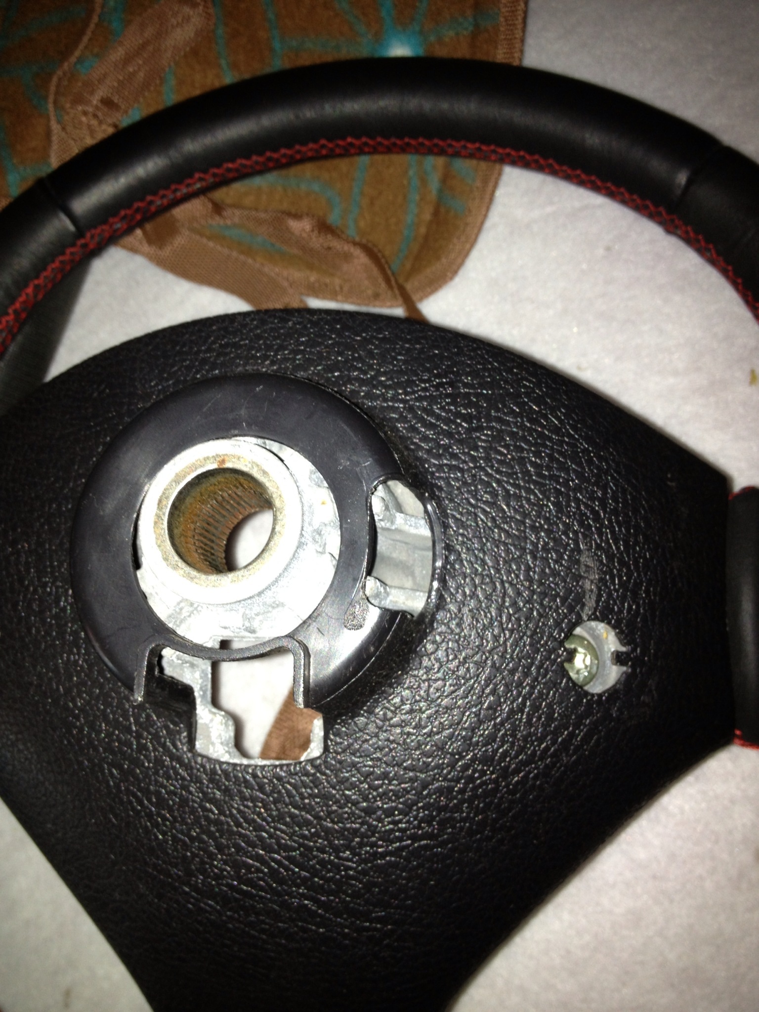

Fit the 206 gti wheel earlier. Little touch I think
[Image: IMG_20130123_125407.jpg]
Question z.. I've resistored round the air bag light, but the air bag connection looks like it will for, wondering if anyone can confirm it works across the models

I saw a GTi180 steering wheel on eBay and thought the same thing. I wonder if anyone knows? Trouble is, if you're wrong it's an expensive and potentially dangerous thing to find out!!
Looks good. Airbag is a funny old shape though!

I thought the connections were going to be different. I was going to try it but I suppose I'm just a shitty bum
Chris feel free to buy one and try it...

It works well. But you need to make a new hole for the cable/connector to keep signal-stalk-actuator working. It has to be 9 o'clock position in 306 and not 6 o'clock position like in the 206.
Important!!!! you need a pre-facelift airbag-steering-wheel with the screws to fix the airbag. The other models of multiplex models with springs to fix the airbag have an other offset and can-bus-signal. =won't work in the 306.

I think mine is pre facelift... thanks for that
