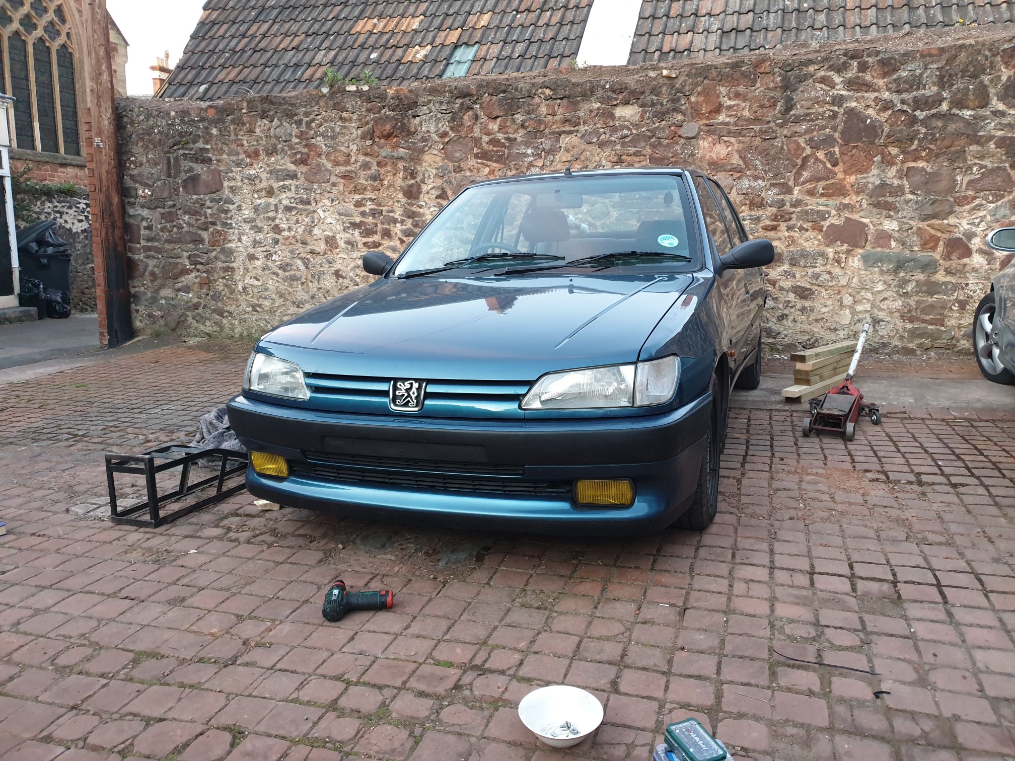

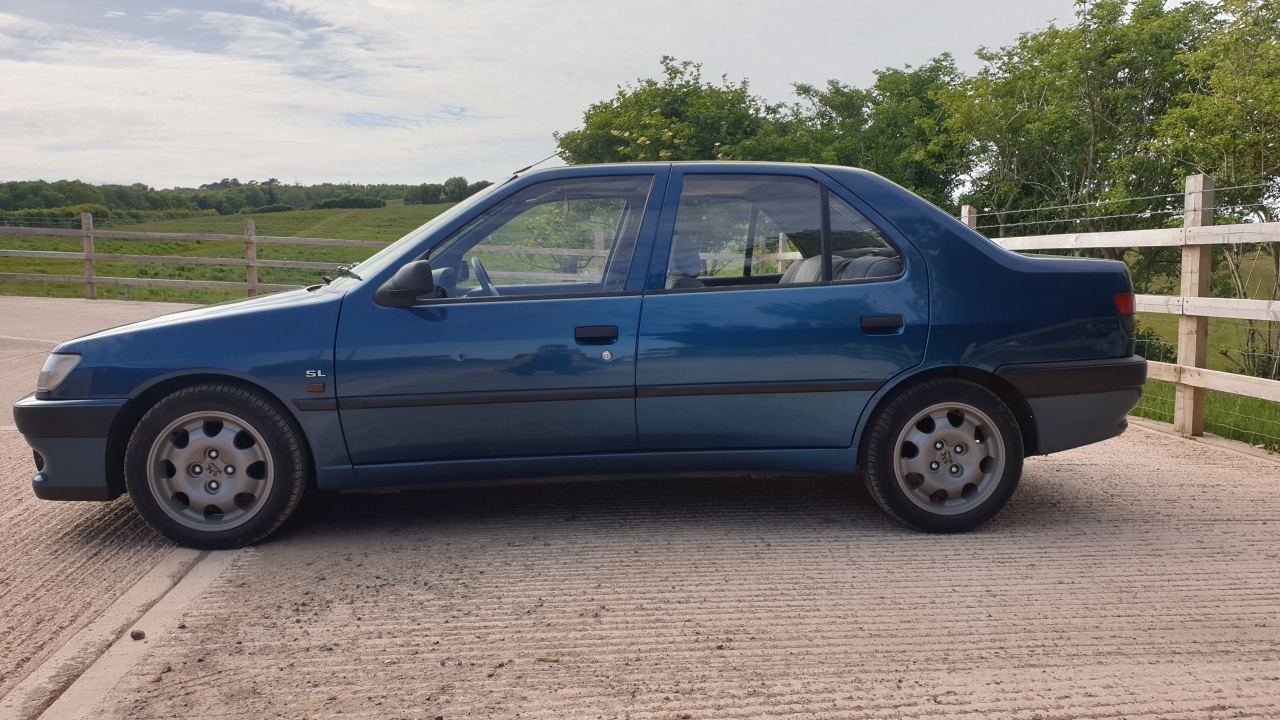

Picture of the car after a clean and completely stock.
attachment=32057]

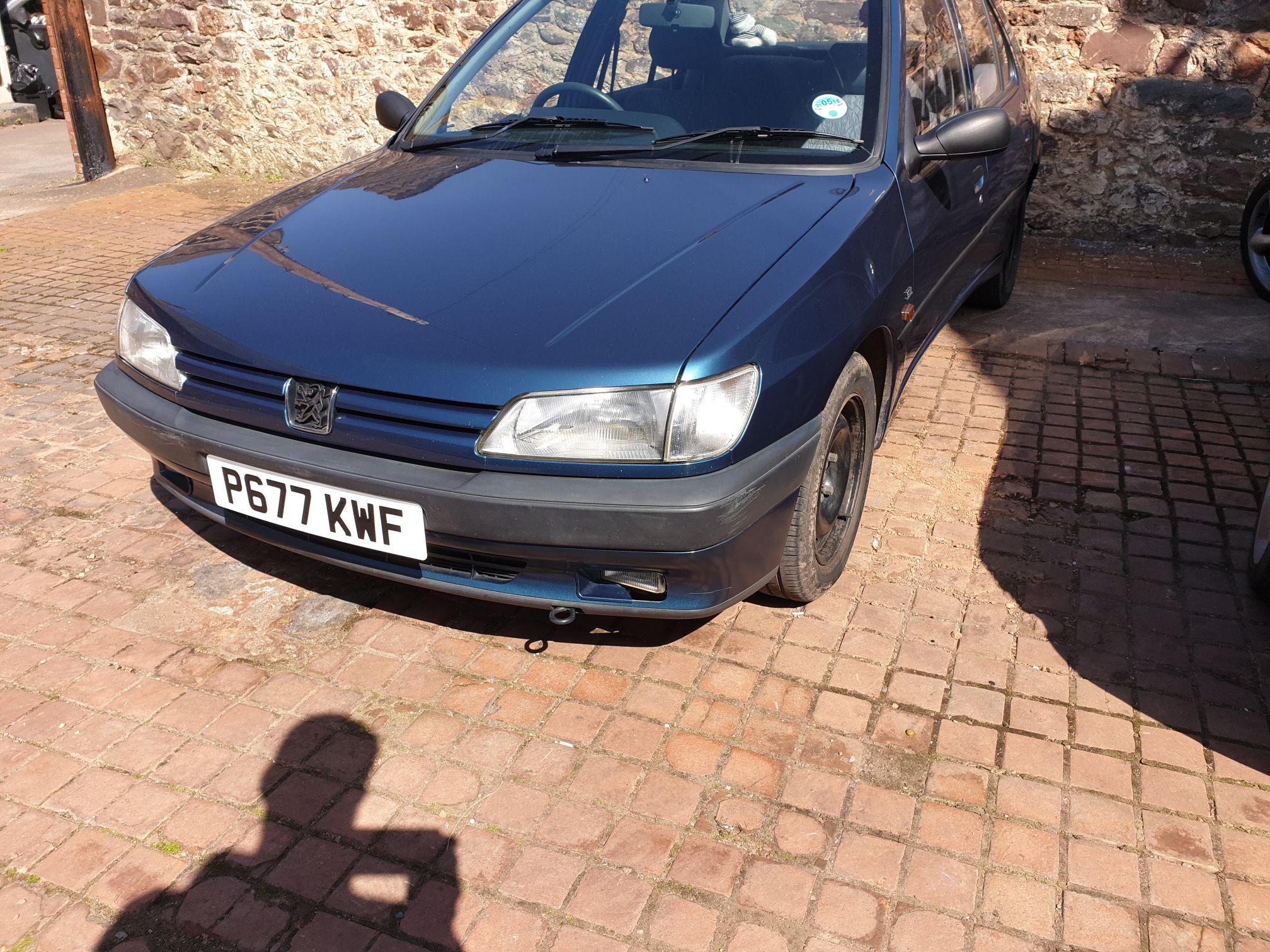

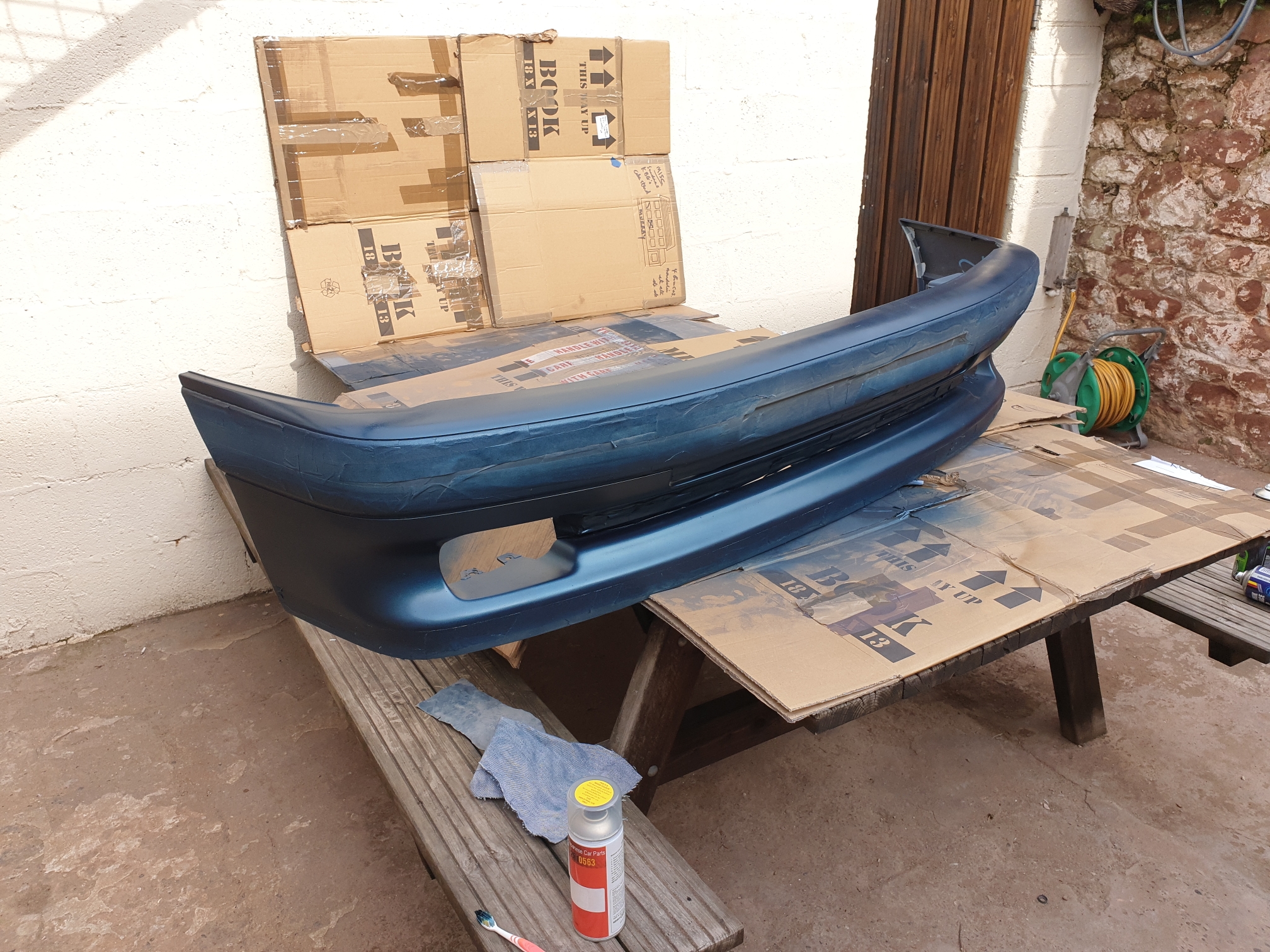

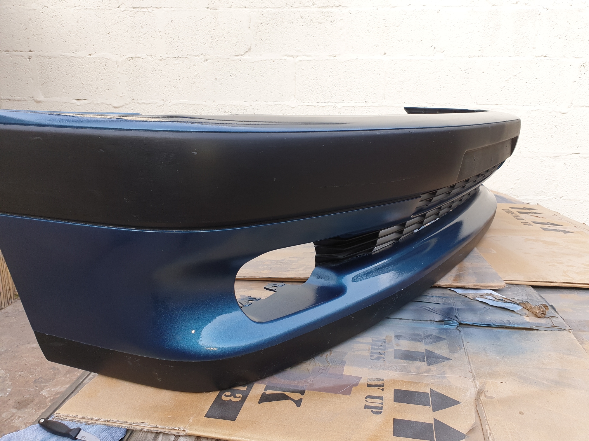

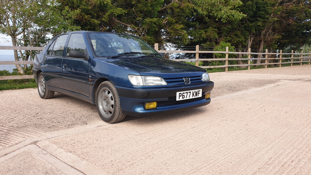

My first purchase was a phase 1 dturbo front bumper, I don't have any pictures of the bumper when it arrived but it was an absolute mess! Full of dents, nasty scratches and missing brackets for the fog lights and the nearside bracket to hold it onto the car. Get what you pay for I suppose! It was also the wrong colour so I went about a respray.
attachment=32058]

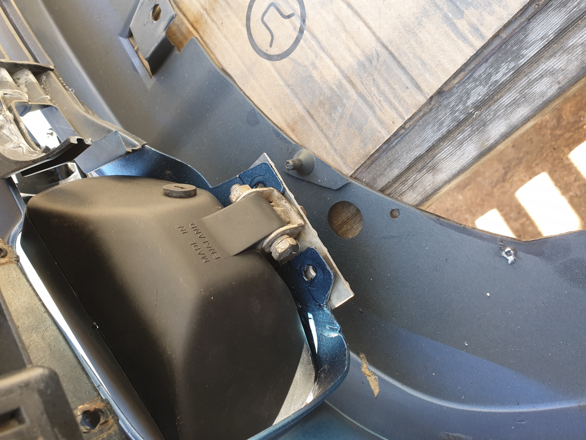

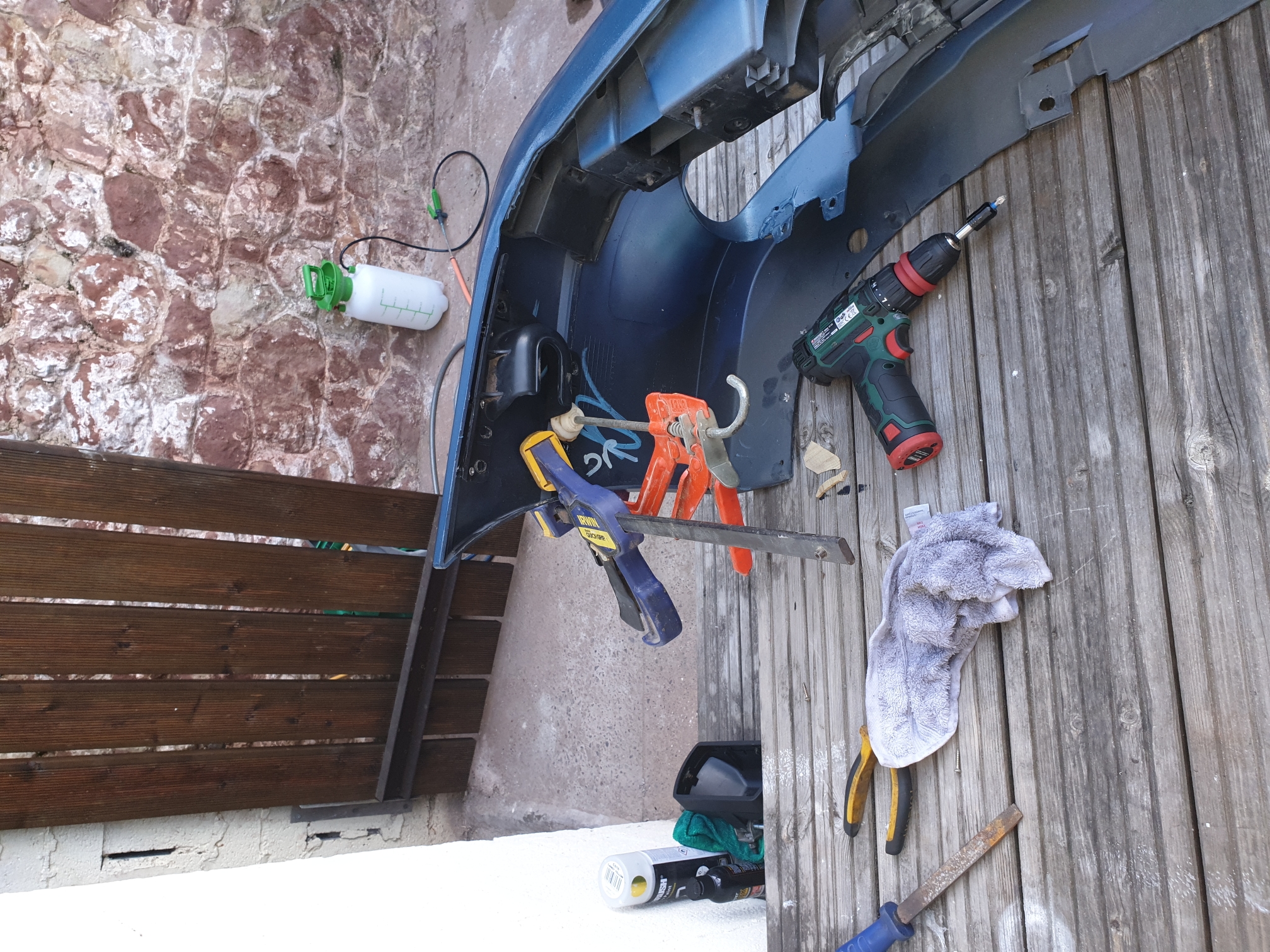

Swapped the brackets over from the old bumper using strong glue and a couple of short screws for good measure.
attachment=32060]
attachment=32061]
Brackets made for foglights using steel (I had no idea what the original brackets looked like but these work just fine)
attachment=32063]
All dents gone thanks to some body filler. Paint also came out surprisingly good considering it was an outside paint jobby!
attachment=32064]
The fog lights were smashed so I painted them yellow which seemed to hide the damage very well!
attachment=32062]

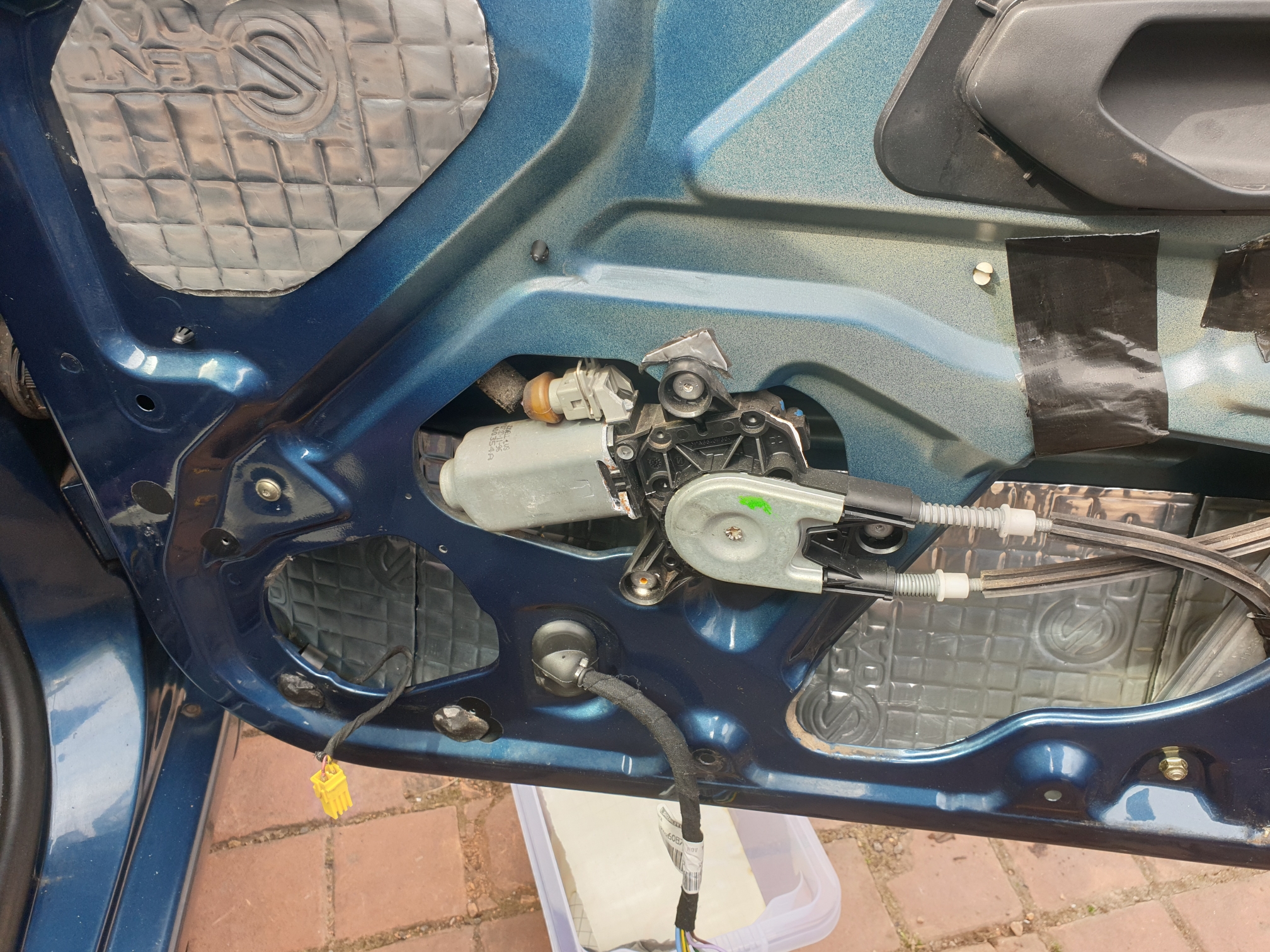

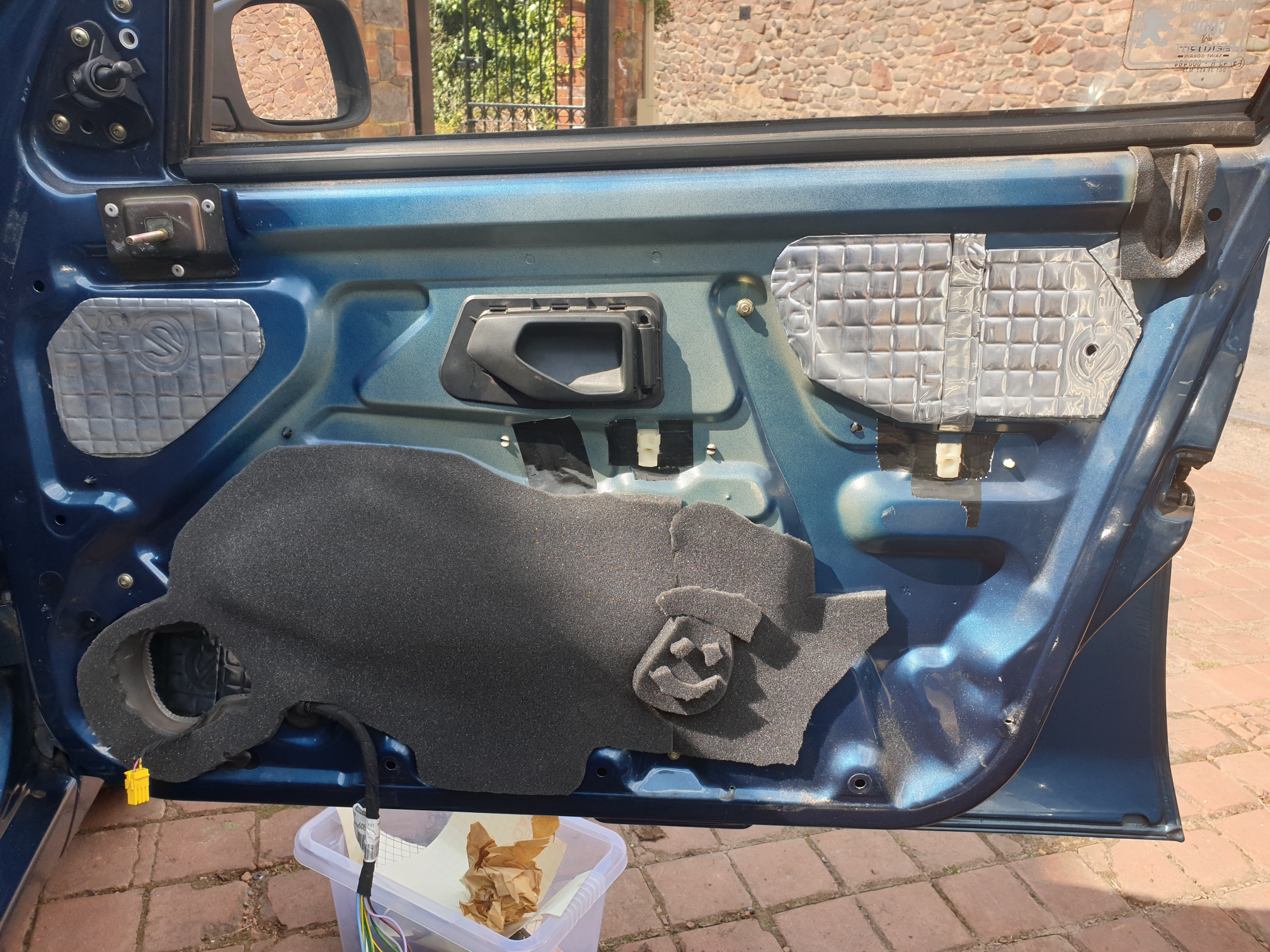

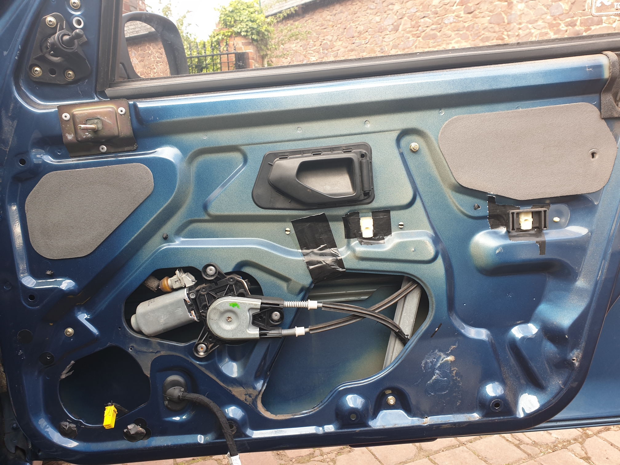

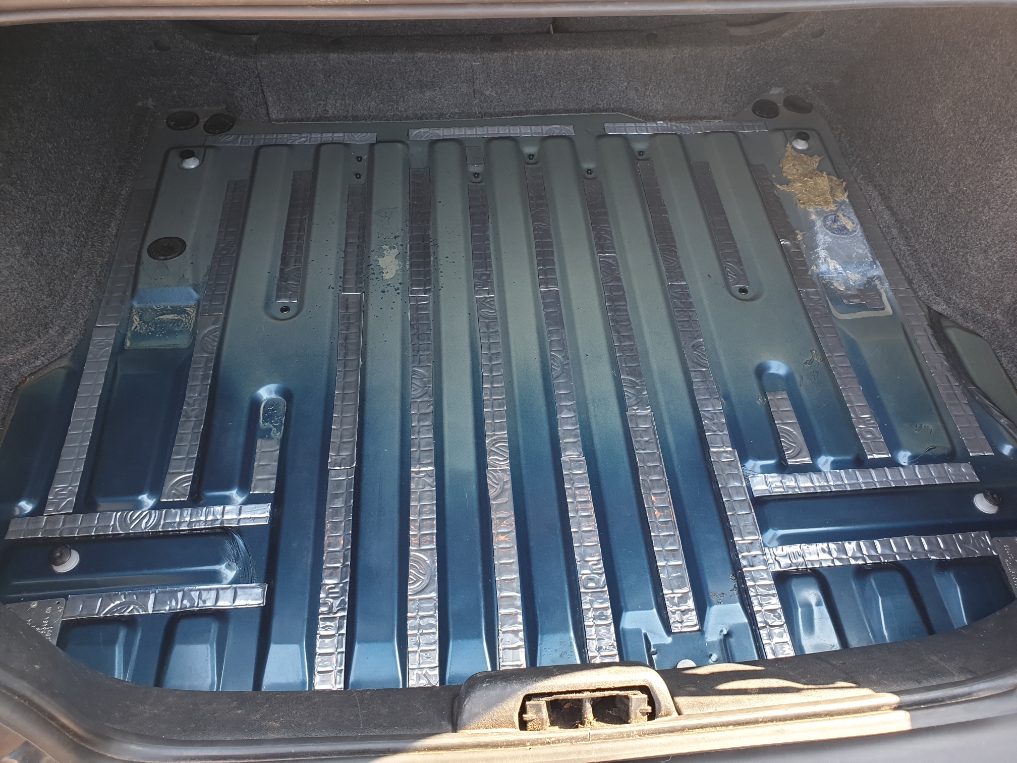

I've been busy again, sound deadened all the doors and had enough left over for the boot. It made a huuuge difference to audio quality whilst on the move.
attachment=32068]
attachment=32069]
attachment=32070]
attachment=32071]

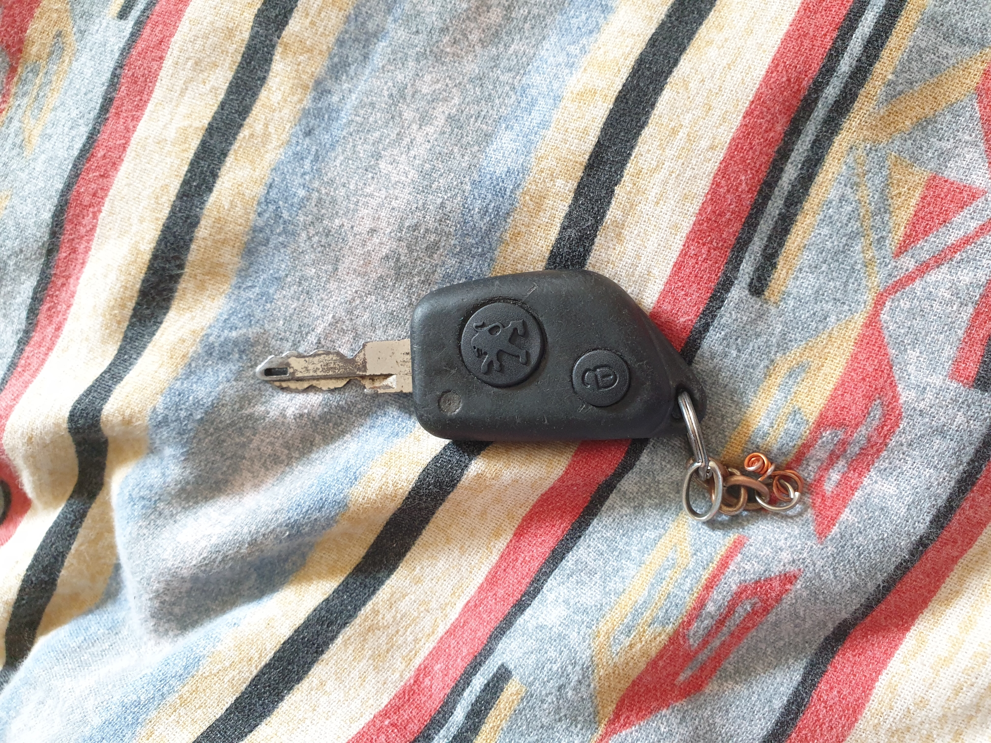

And made the key look pretty again.
attachment=32072]
attachment=32073]

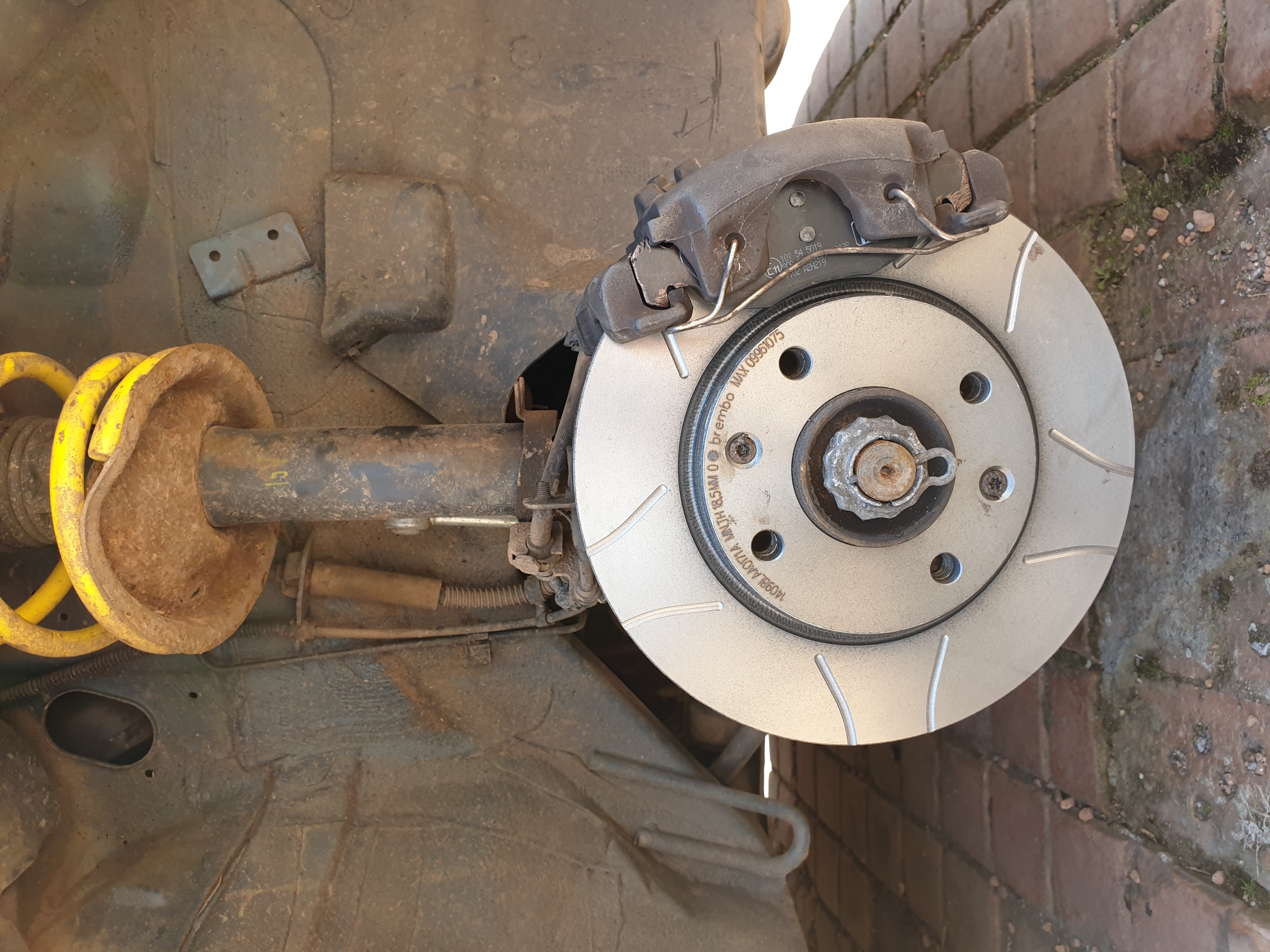

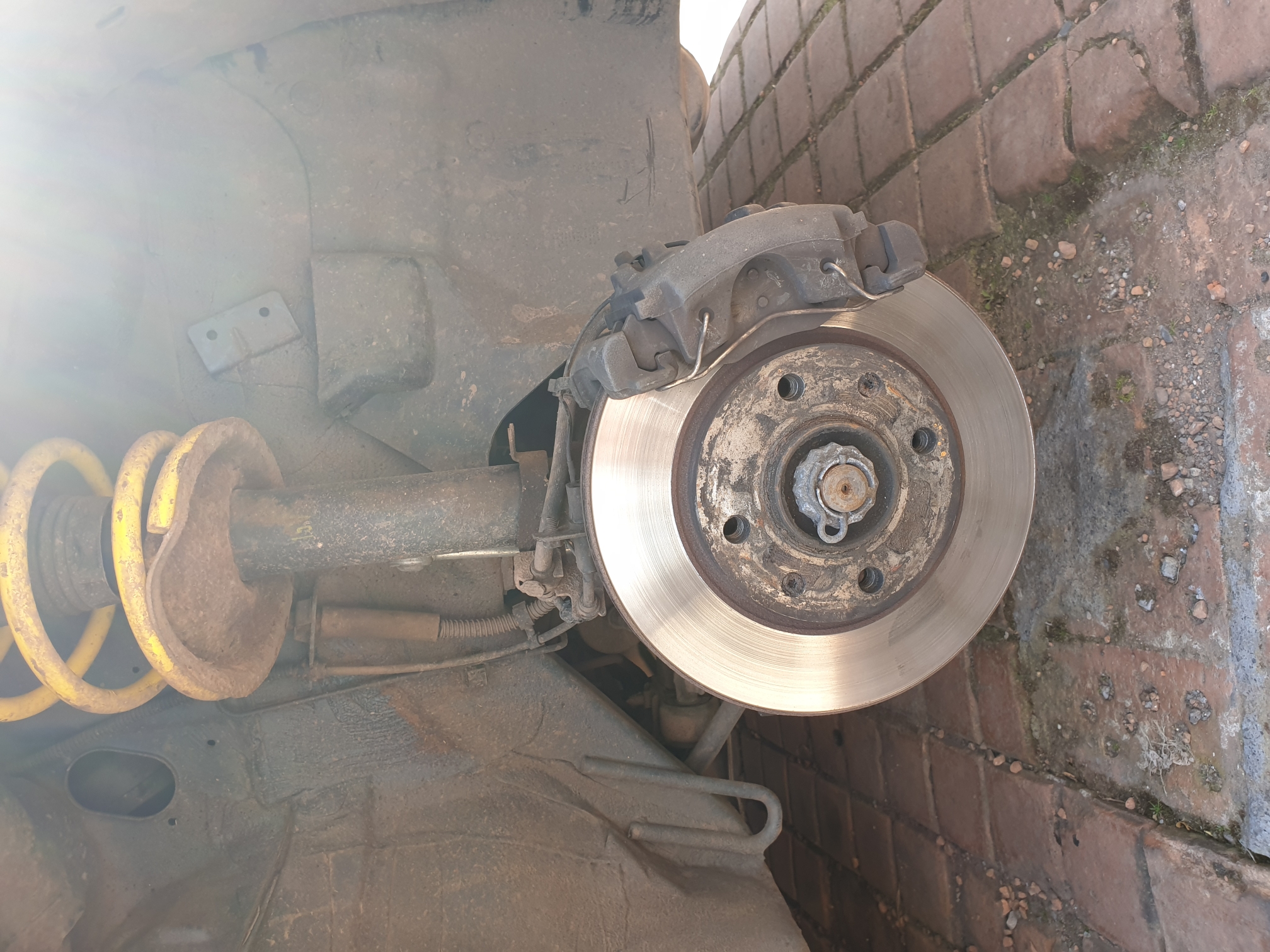

Front brakes needed replacing (due to a poorly misjudged hammer blow when replacing springs) so I bought new pads and a pair of brembos discs. £33 for a pair on eurocarparts!!! Bargain, must've been old stock.
attachment=32074]
attachment=32075]

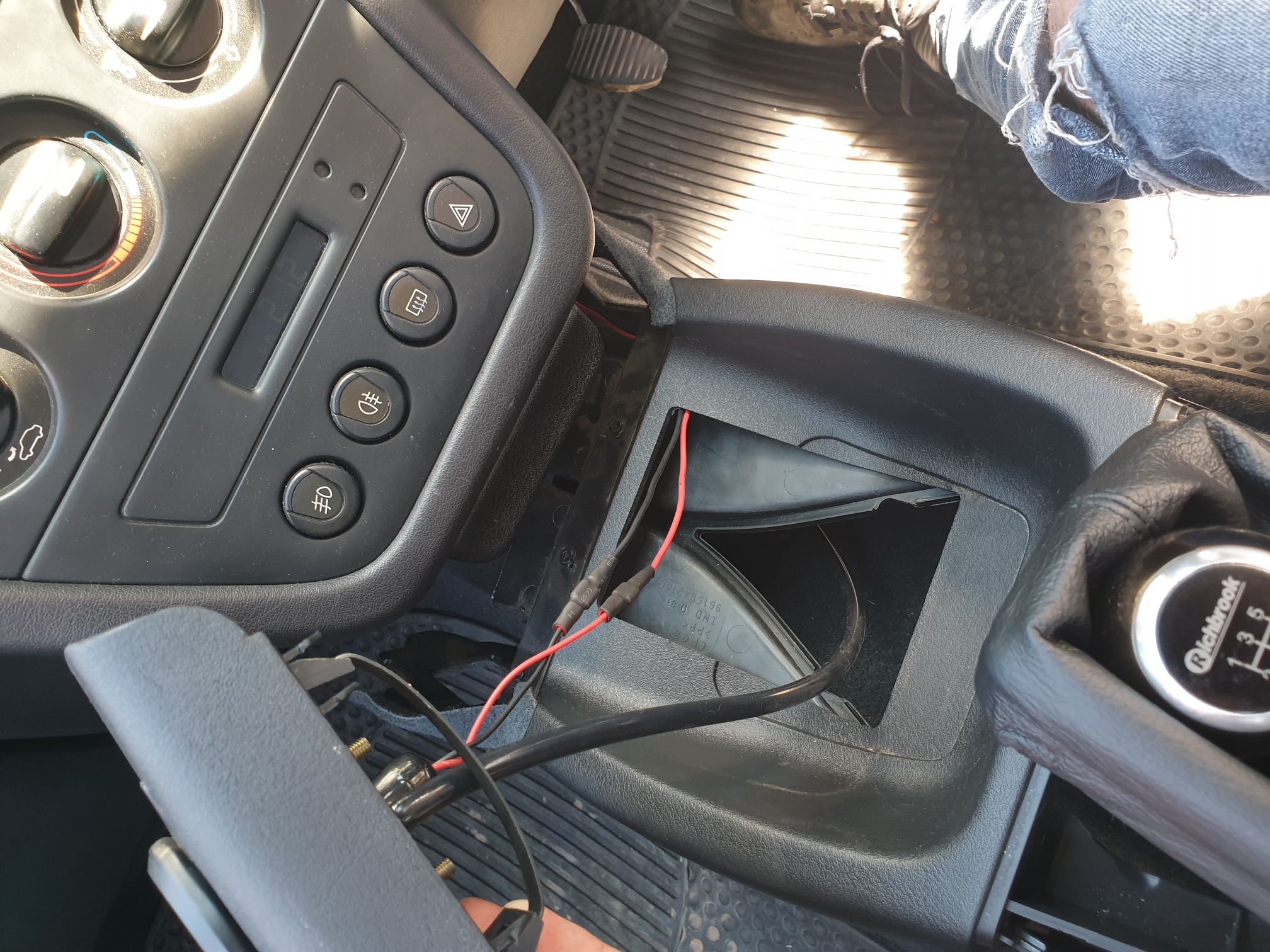

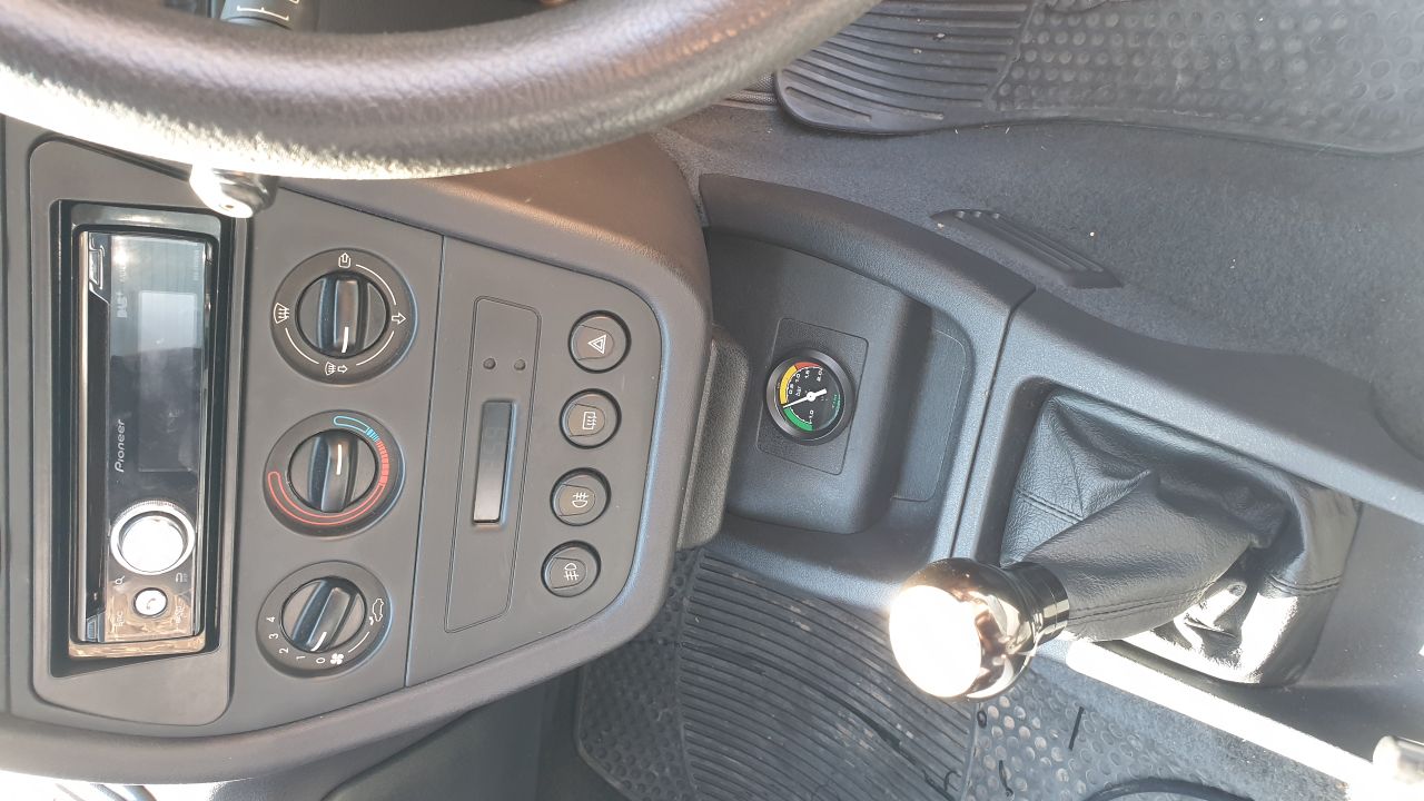

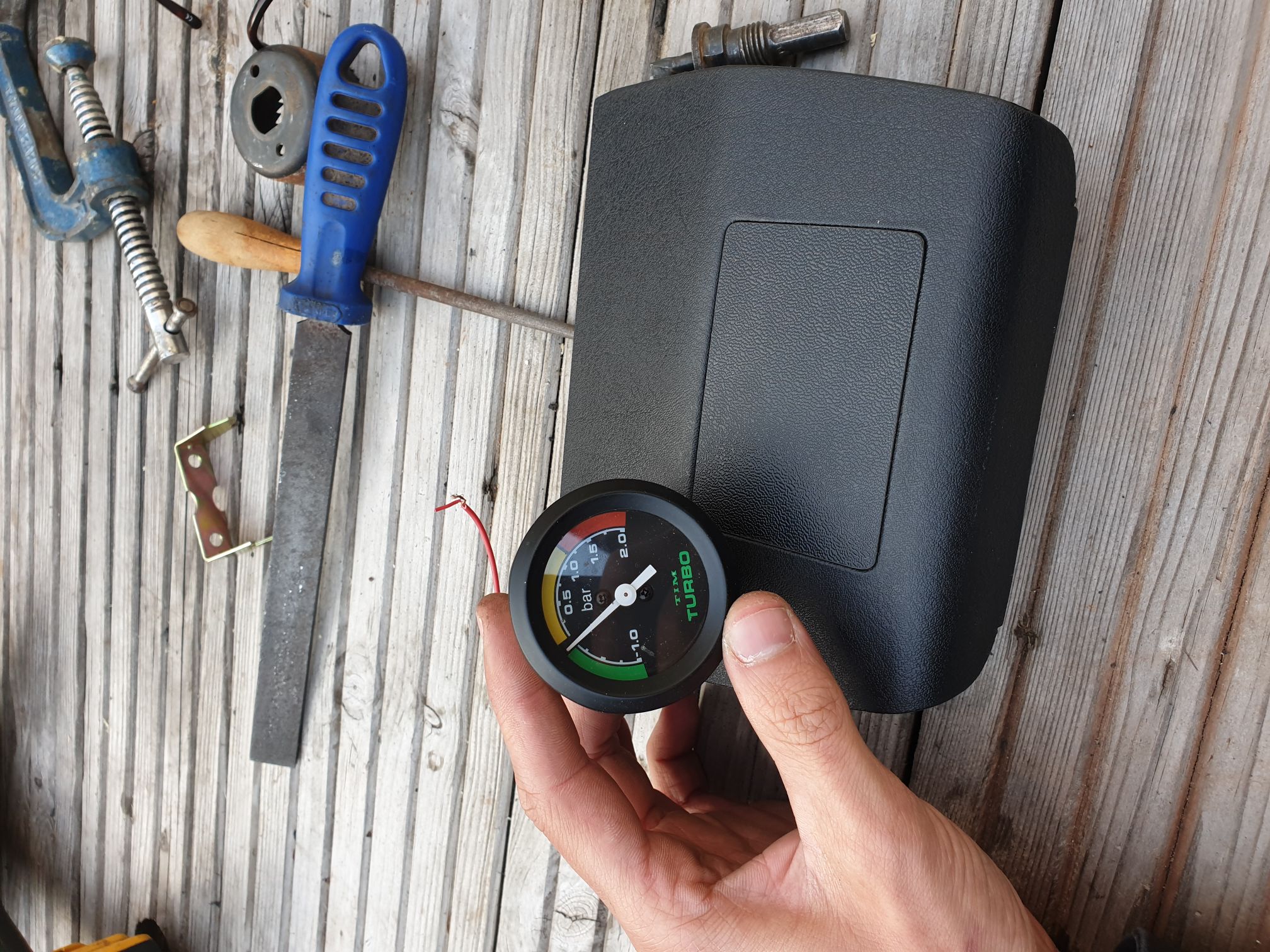

Boost gauge is now in. After looking through the cars paperwork and seeing the number pad had been disconnected I thought that would be the best place for the install. I bought some ABS textured plastic off Ebay to match the centre console plastic (or near enough) then cut and filed to fit. A 52mm hole saw was used to make the hole for the boost gauge, then some more filing!
attachment=32080]

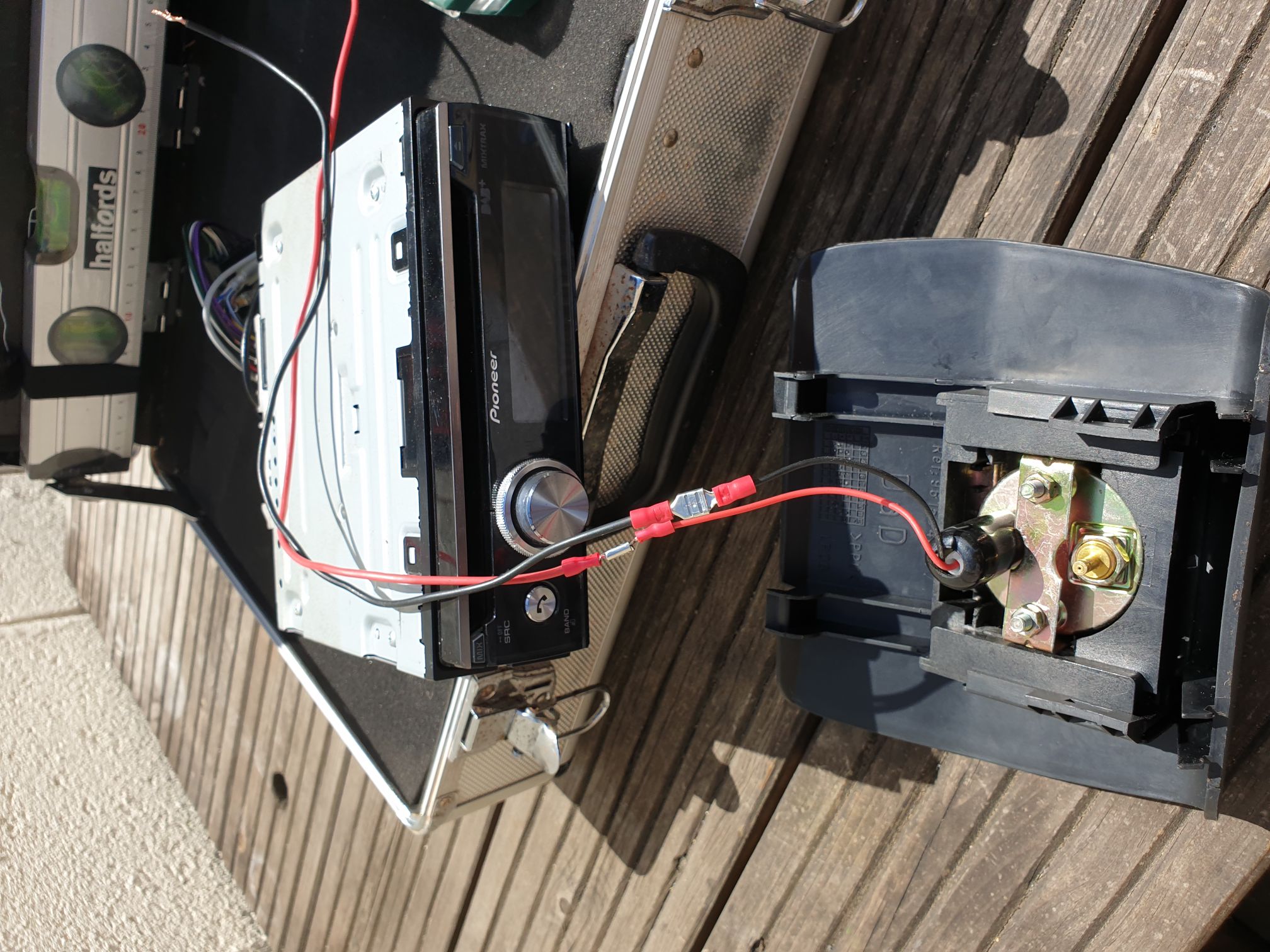

I spliced into the wires coming from the back of the stereo to make sure the display on the gauge only lit up when the headlights are switched on.
attachment=32081]
attachment=32082]

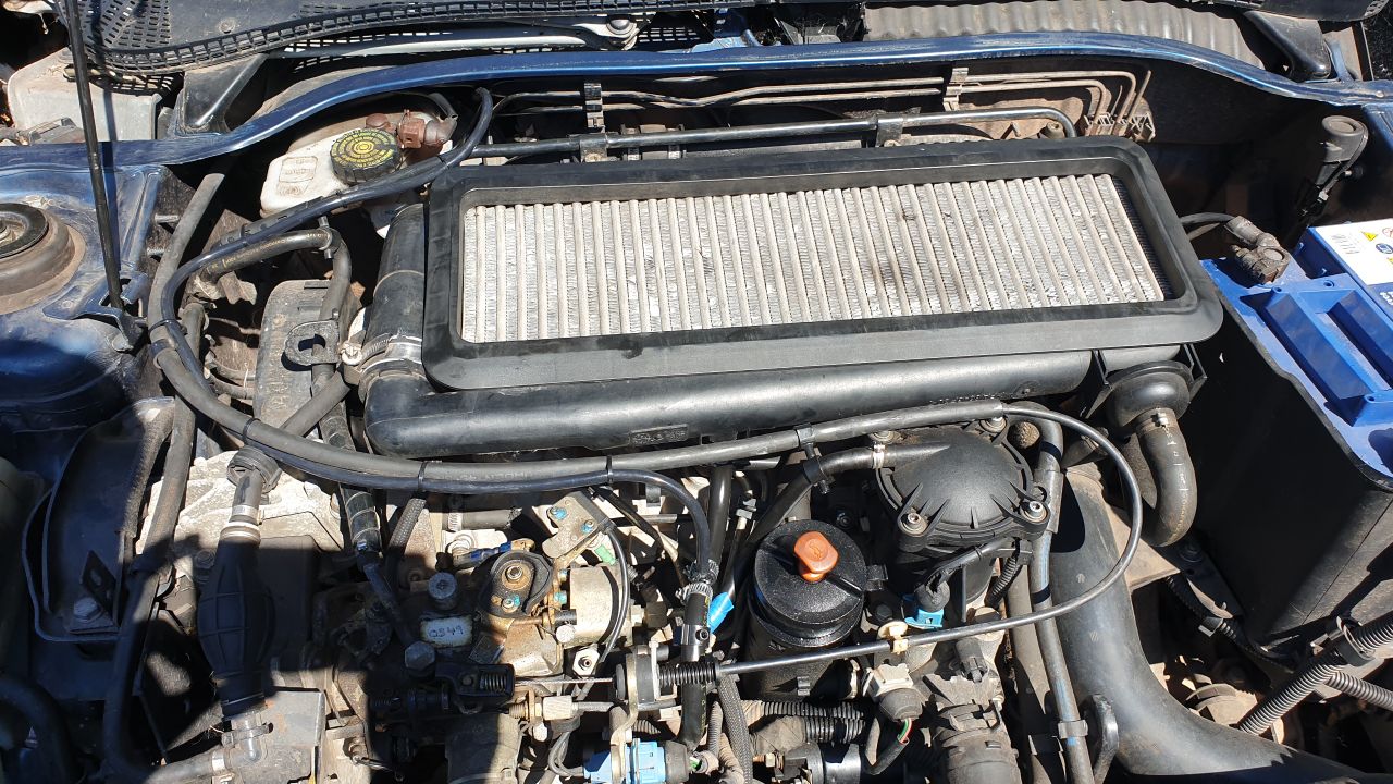

I used the grommet just to the top right of the brake servo, It was a right pig to get back in!
[attachment=32083]
Just in case anyone is unsure on where to plumb the t piece into. Zipties at the t piece were only temporary while waiting for delivery of mini jubilee clips. It's also worth noting the t piece used was 6mm 4mm 6mm rather than the 4mm 4mm 4mm gauges usually come with.
[attachment=32084]
I think this gauge looks great in the car. When tested the car is running .8bar (around 11.5PSI) which IIRC is healthy for a standard Dturbo engine. Unfortunately the second hand gauge is sticky on the way back down to zero, and rattles like mad! It functions and will do for now but a replacement will be needed at some point. A manual boost controller is also on it's way!
[attachment=32085]

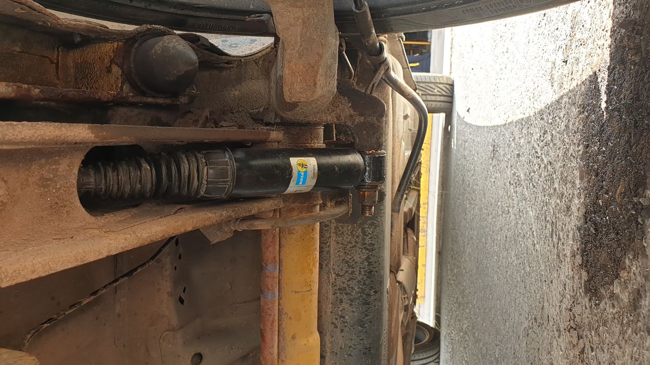

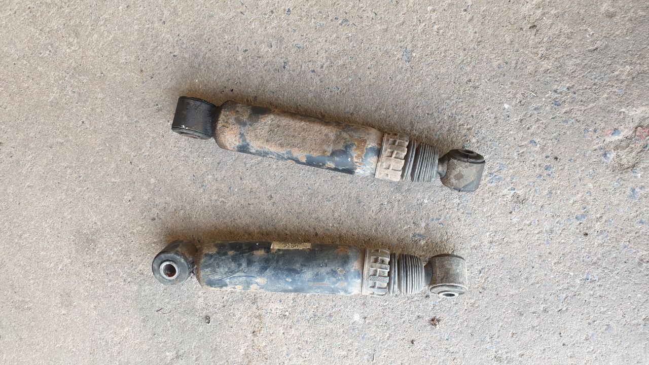

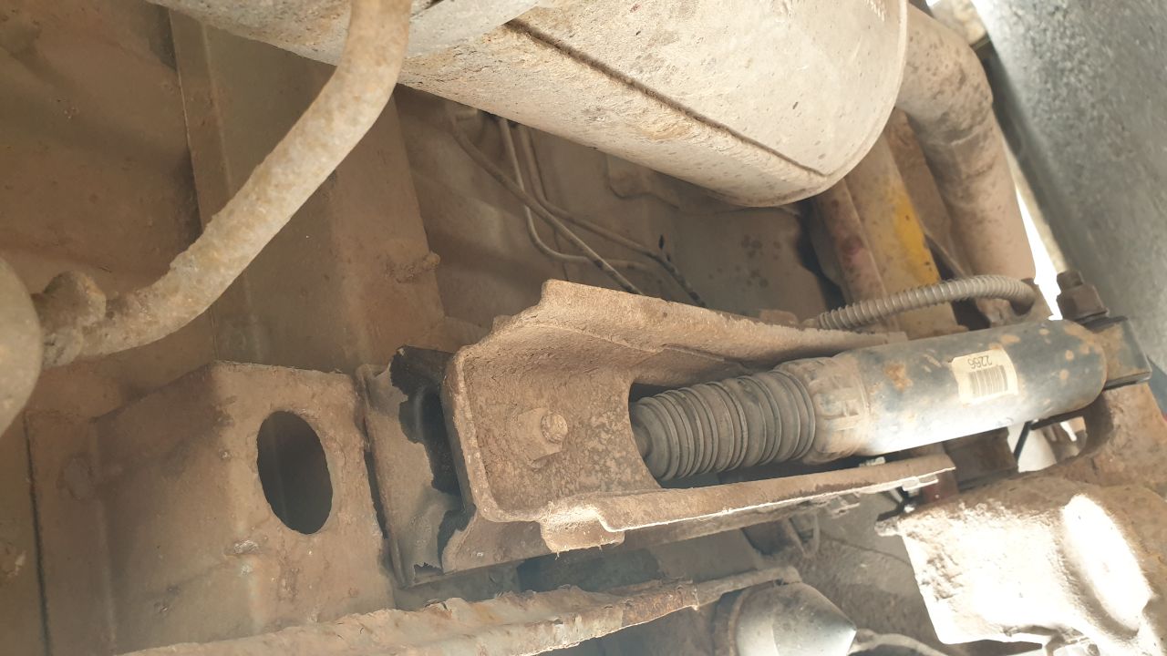

In the meantime I replaced the rear shocks as the rear end felt quite loose, I went with bilstein b4s for the replacements, second hand but very cheap and in good working condition.
attachment=32086]
New ones.
attachment=32087]
Immediately it was obviously the old ones were properly knackered! When compressed they were very notchy and didn't even spring back out again!
attachment=32088]
Only took it for a very short drive around the industrial estate to check if all was well and it felt 10 times better than before, the reaction time of the rear suspension (if that makes sense!) over even small bumps was vastly improved, it feels much tighter. It will be great to have a proper drive in it once the brakes are fixed.
