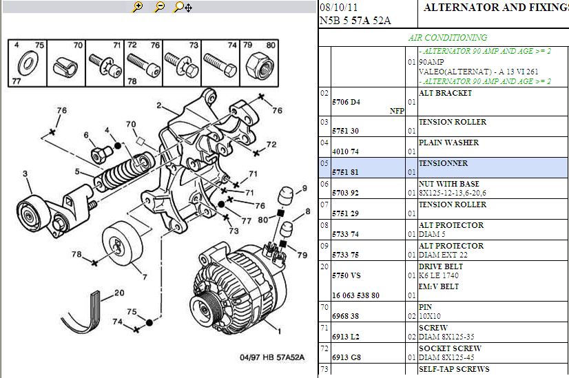

As Weka says, looks like you need one or other of the parts from image 1) in your first post, or possibly the second tensioner roller in the belts run.  Depends which part failed.  The tensioner is the spring-like part (5751 81) and the roller that attaches to it is 5751 30. Second roller is 5751 29.

5751-29 is quite similar with my tensioner now (one round hole , one square hole) and i just using 1 tensioner now....i know it should be at least 2 tensioners in a car with power steering and AC but now i'm just using one because i have no idea what kind of tensioner i should buy....i think its make my belt squeaking alot (because i just pick any car parts that can make my 306 works temporary....not set the belt yet in proper stock mode as it should) ... even i can hear the squeaking sound from 20metres
