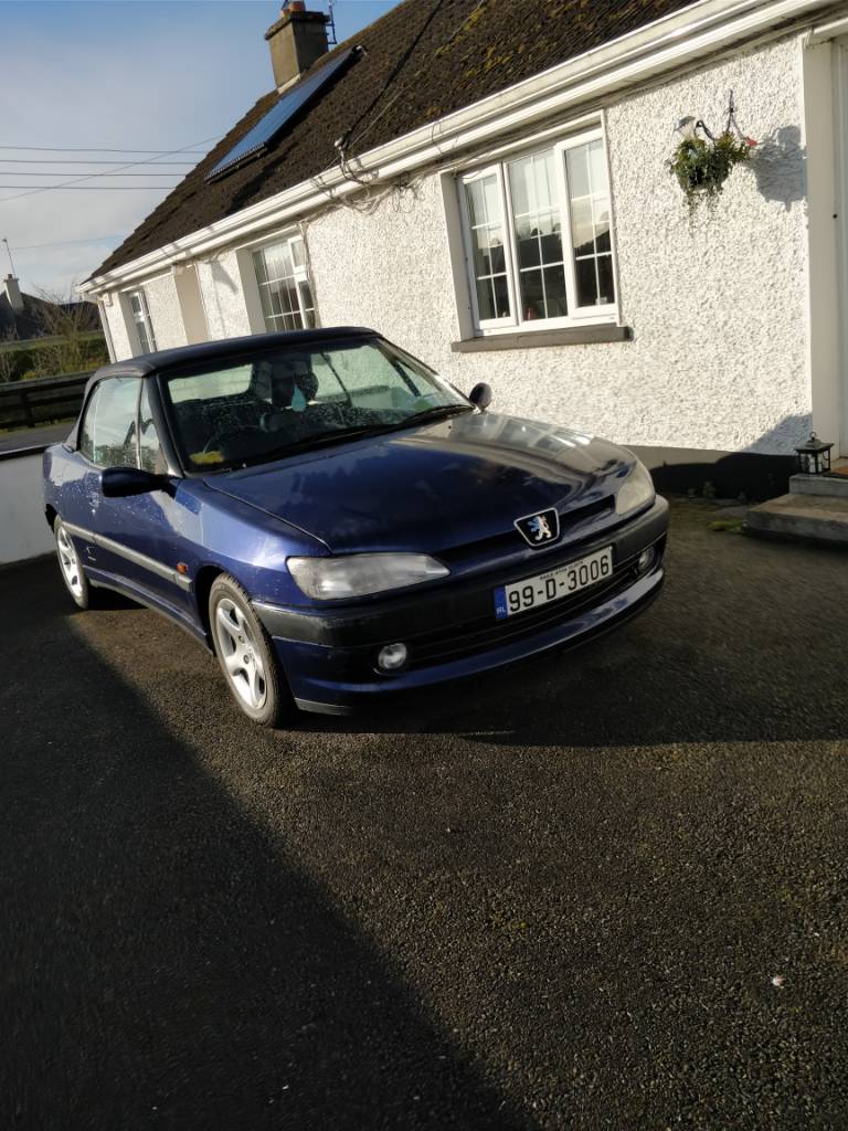

So picked her up this morning, 78k miles, no tax no test, a VERY milky back window, roof operated manually as the hydraulics had long since given up the ghost, according to the seller.
He had owned it for 18 months after buying it off his friend, who had had it a similar length of time. A nasty scratch that runs the passenger side of the bonnet to the petrol tank filler cap on the driver's side rear quarter panel.
Test drive showed everything as should be from what I know about 306s (this is number 4) so handed over some notes and off I went home.
Didn't miss a beat the 70 mile trip home.

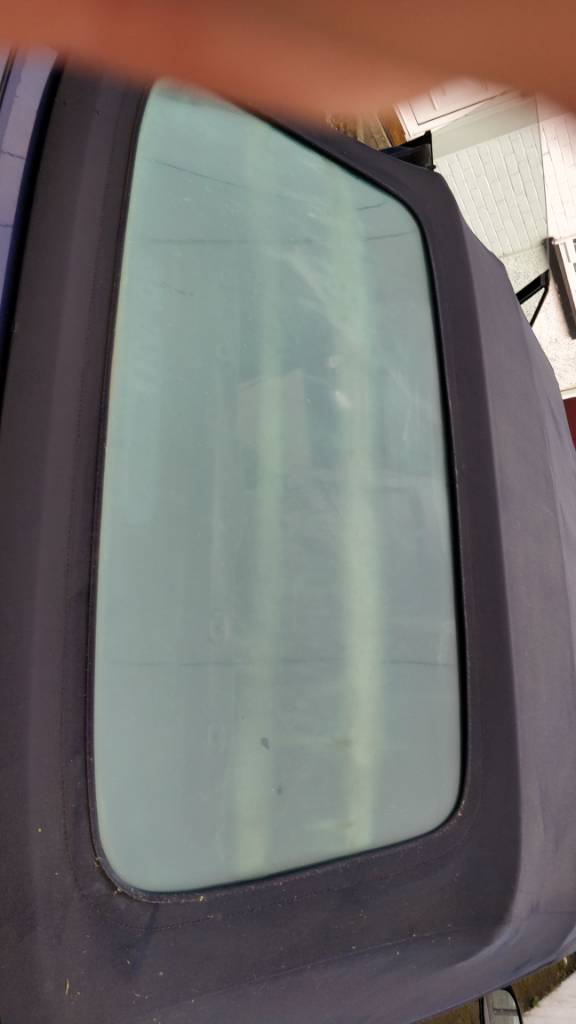

First morning in a long time it's been dry enough to step outside without getting drenched, so fitted the new battery and treated the rear window to some plastic polish I got which made.... No difference at all! It doesn't bother me much as I rarely use my rear view mirror but was wondering from an NCT/MOT point of view would it be allowed? Also replacing the battery didn't fix the rev counter twitching, any ideas? [attachment=31163]

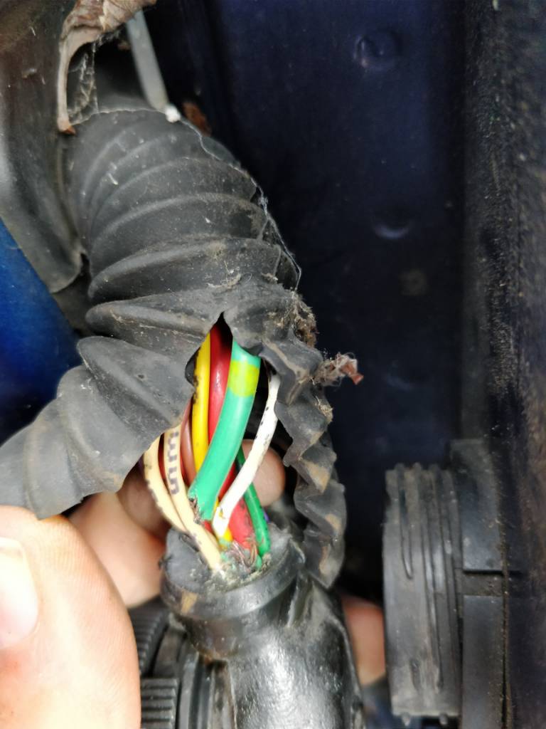

Happy New year! Did a bit before Christmas, namely resoldered the door loom where the wire for the window and the central locking had worn through, so any time you lock it with the key the locks would unlock immediately after locking. All sorted now though! Insurance expires on my other car on the 18th, so going to Renew it on this, and then have something to pick the kids up in (no personal mileage on company van) [attachment=31202][attachment=31203]

So NCT time on Saturday morning! Friday night (minus 2 degrees) I went out to check all was well and fit the daughter's seat, I ran my hand over the rear window and it cracked! Had anticipated it failing anyway so taped it up with clear parcel tape and drove it in.
Unsurprising- it failed
Surprising- no mention of the rear window!

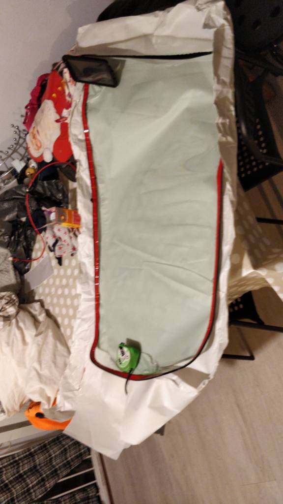

Postie came! Rear window and hood bin lid seal arrived this morning from Bulgaria!
Ordering the suspension bits tomorrow. [attachment=31859]

Is this a rear window from Eftim? Hear good stories about these! And he is a seller one can trust!
I am also working on a China Blue converible to get her back to 100% condition!
Yeah it's one of his! Going to fit it once the weather gets a bit warmer, and I'll let you know how it goes! Others on here have done it and had no trouble. You have any pictures of yours?

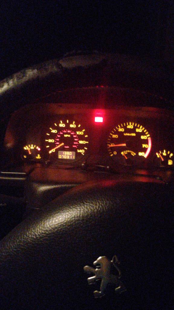

Following a mishap when jump starting before the test, when turned on the dash was reading 140mph, 8000rpm, a full tank (that's when I definitely knew there was something wrong) and for every 100 yards driven the mileometer was going up 50 miles! Anyway, sourced a used set of clocks on eBay, arrived and popped them in (5 minute job). All working and back to normal. Only thing is the mileage is obviously now incorrect. Can this be altered, or just leave as is? [attachment=31871]
