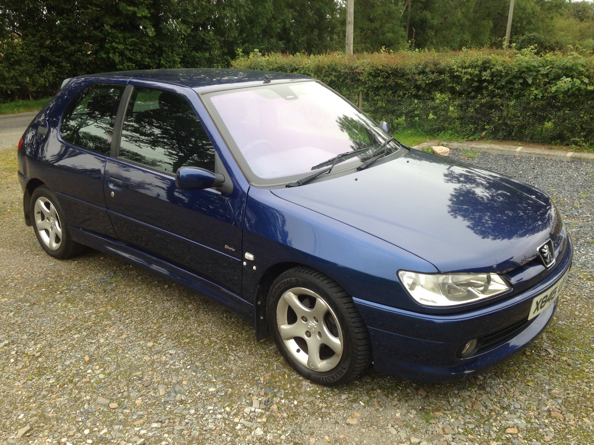

So I have been a member on here for a long time. Have had 12 306s in the past and always wanted to get a good straight car and have it with some small modifications to my taste. Living in Northern Ireland unfortunately once a decent one comes along it is slammed and screwed and within the year it's in the scrap heap which allows me a lot.
So moved house 18 months ago with the dream big garage. 1st on the list was source a genuine straight car. It was for sale at a car wash and as you can see in photos was in need of a little love!

Looks good, best of luck with it

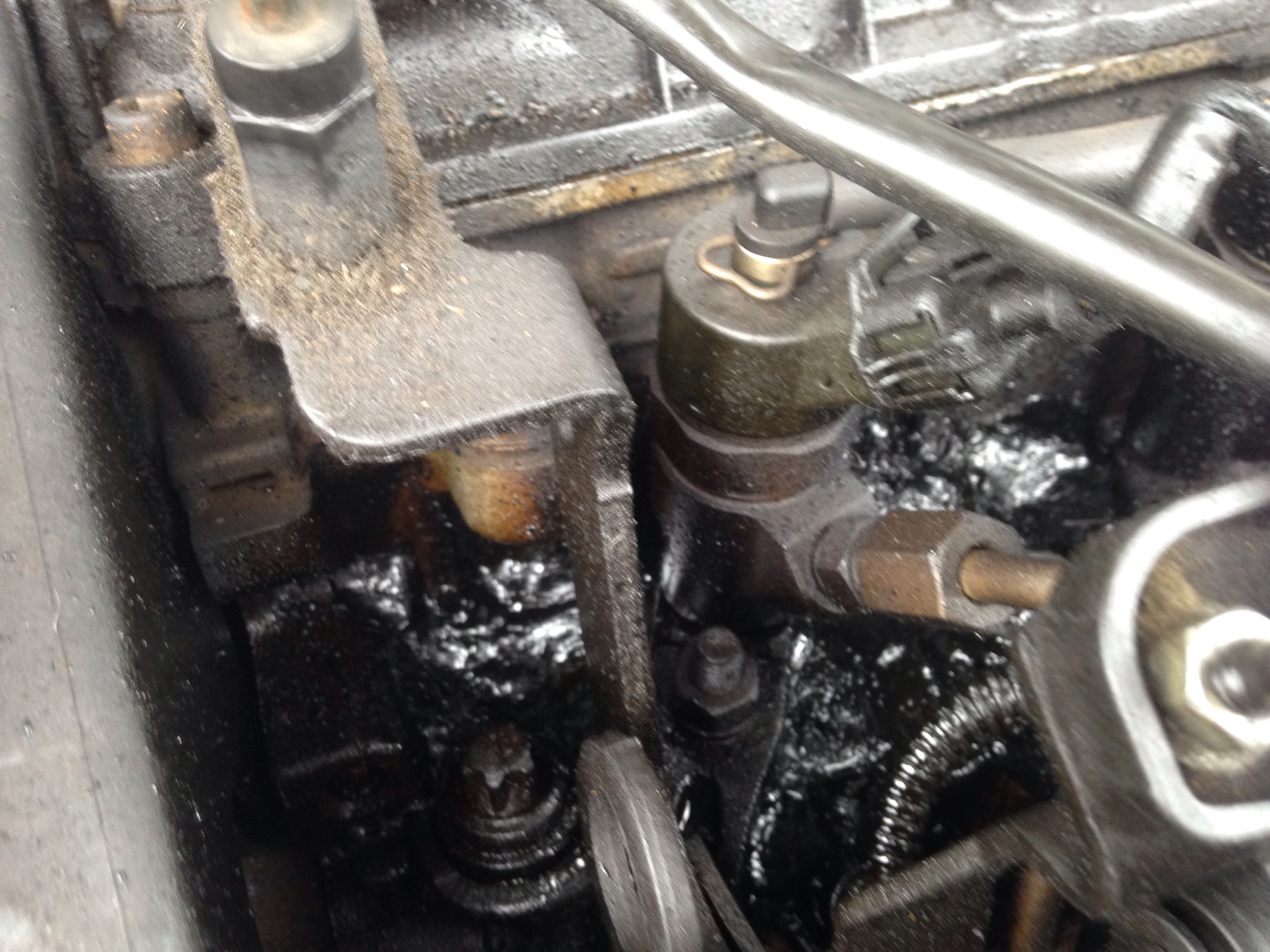

A really good service was needed and it was clear that At least 1 injector seal was gone.
So into the garage with it!
So took into a service. Oil flush, oil and filter change, air filter and diesel filter. It was clear where the spitting noise was coming from. 3 hours later, injector 1 was removed followed by the remaining 3. Had them tested and cleaned. All excellent results so reseated the new seals and that was that.

Oooo plenty of combustion crap blown through there, have fun cleaning it off! Scrapped the mother-in-laws a couple of months back and one of the injectors had pretty much disappeared. lol

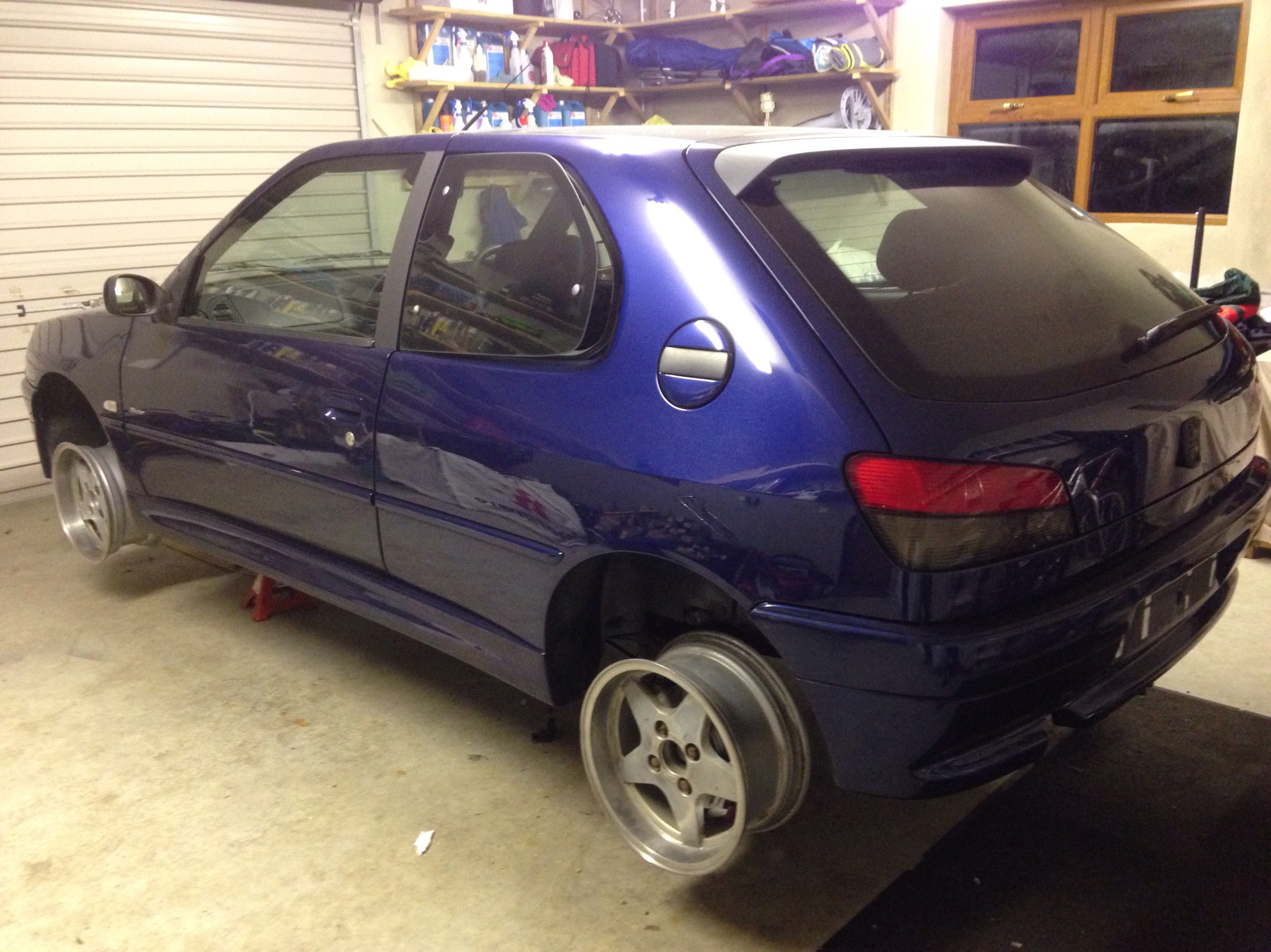

So after a few weeks of evenings all the above was fitted. Gear oil was due changing from 90k ago.
All brake pipes were cleaned and greased as car was overdue MOT.
Unfortunately I haven't got photos for everything phase. She drove so much tighter after the above was fitted.
On the day I brought it home there was a knock from the rear and the brake pedal went to the floor. Turned out there was no fitting kit on the rear pads Huh

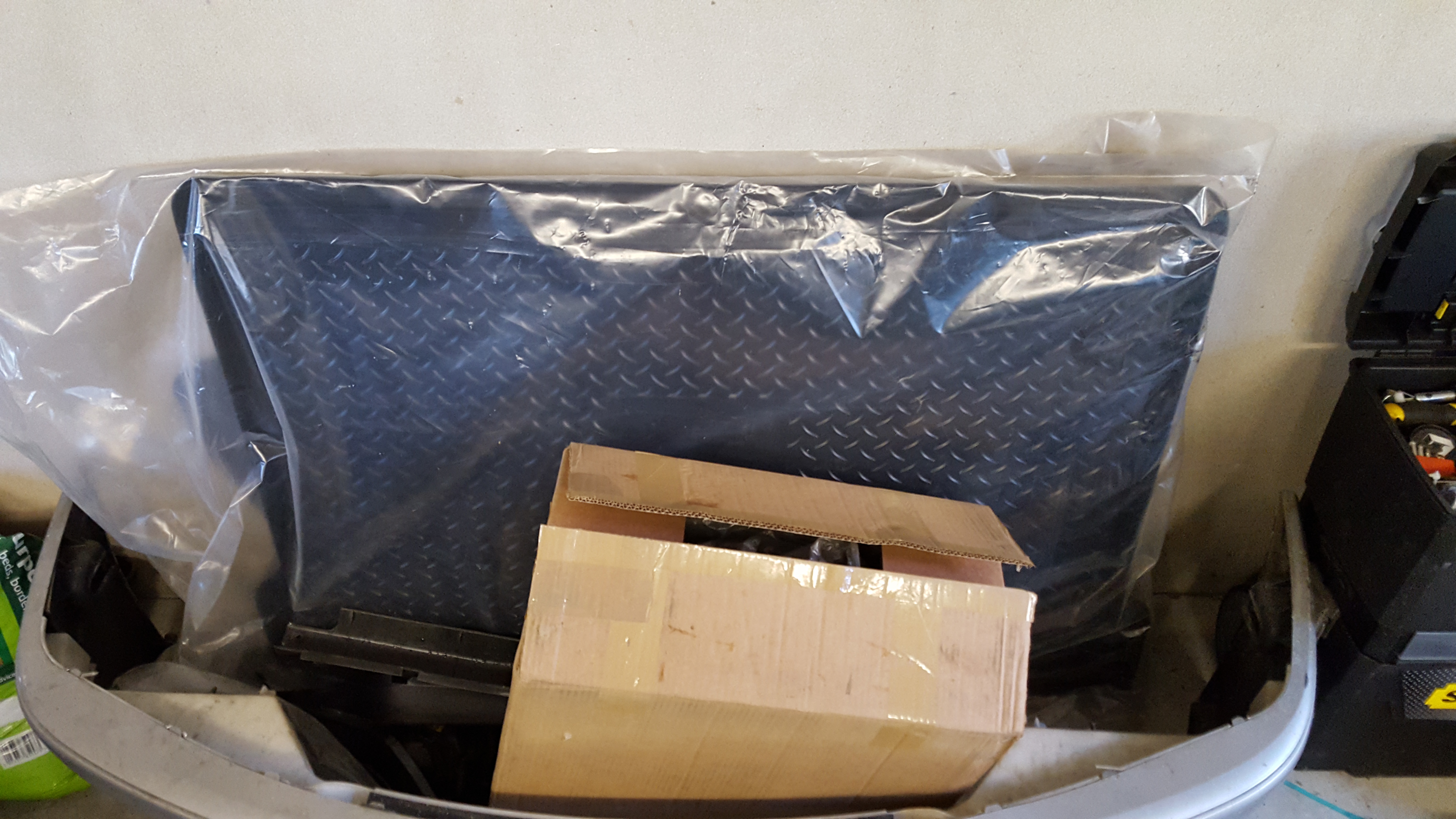

Genuine Peugeot rubber boot floor protector, thought it might look good at shows etc![attachment=29299]

Where did you get the rubber boot liner? Really want one
(31-12-2016, 04:27 PM)Piggy Wrote: [ -> ]Where did you get the rubber boot liner? Really want one
theyre just on ebay i think.
just read up on this thread. fondmetal 4000s! I have a set too. Semi refurbished. if you are short of the centre caps I have made a 3d model and can get it 3d printed and its a pretty exact replica! Big Grin
(31-12-2016, 04:44 PM)Eeyore Wrote: [ -> ]
Superb rims Eeyore. I had a set 3D printed from shapeways for them. Might do something with them someday!
Just keep an eye on eBay as the man says. Think I picked it up at £50
