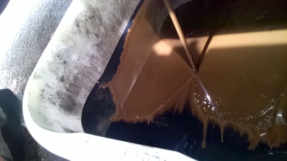

This was the oil (with about 3l of coolant in it.)

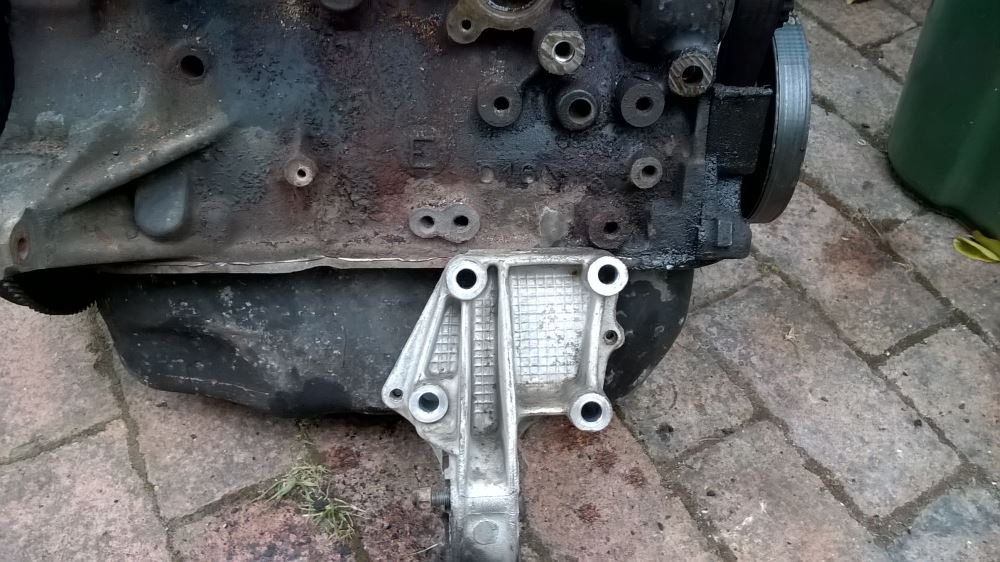

Then spent some time head scratching about the mount that I had guessed would be a straight fit but wasn't. Just needed 1 stud removing and one moving to a different hole thankfully so double nutted them and out they came.
[attachment=24186]
Bottom mount was a straight fit with different length bolts after tapping the holes to clean nearly 2 decades worth of shit out of them.
