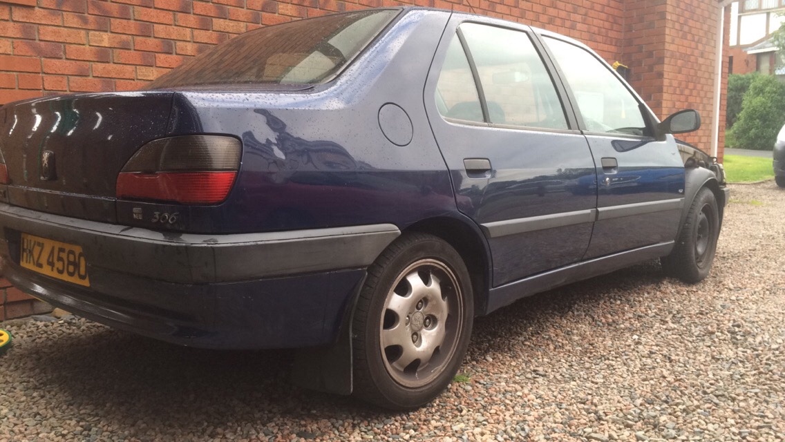

So was browsing through Gumtree last week, usual 306 search, and I spotted one that was up for £250. When I opened it I realised it had an arse on it, you don't see many sedans over here! So I dropped the guy a message to find out about it, ended up driving up to see it and then purchasing it for £170, pure bargain. Runs and drives, all I care about. Bar the 0 mot or tax, so now working on getting it home somehow, and then start to getting it running sweet and a small tune up.
It's a bit rough round the edges, needs a new drivers wing, but apart from that the rest is solid.
[Image: e89daf9eb69884b6ec8a91aab884b342.jpg]
[Image: 79c99d7efbce13d3546fc42a8751f723.jpg]
Looks good in the dark blue
oh man would have been better if it was black but looks good. bargain!
Plan of action is just to get it road legal first and then look into tasty bits, mainly brakes just need worked on, no real suspension issues that I noticed. But gonna swap out the struts for a newer set I have in the garage and a GTI6 front ARB.
Looks great for the price,good luck with it.

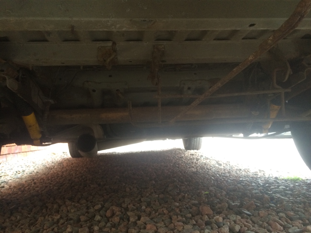

Finally got her home at 2am this morning, woke up to her on the drive, few mates went and lifted her for me. Looked underneath her before heading to work, no rust on the sills, and they're fully in tact, not crumpled like my HDI!
Chuck a few more photos up when I get the chance.

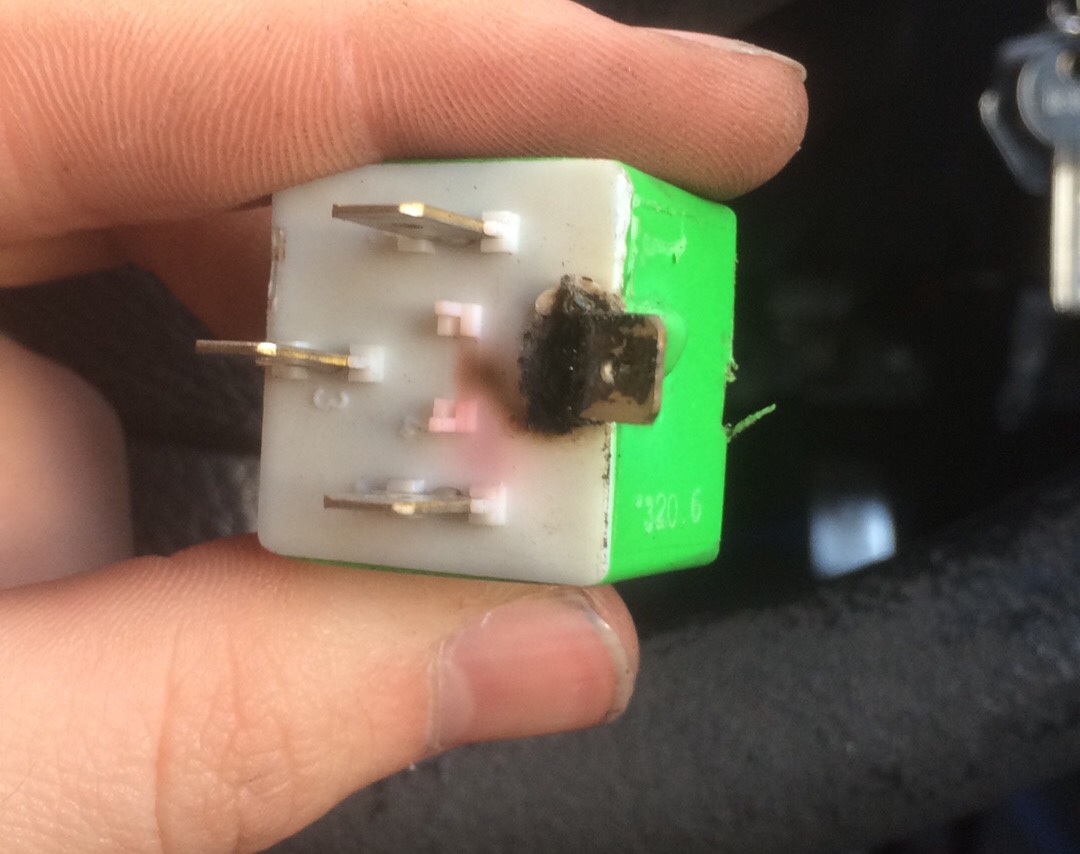

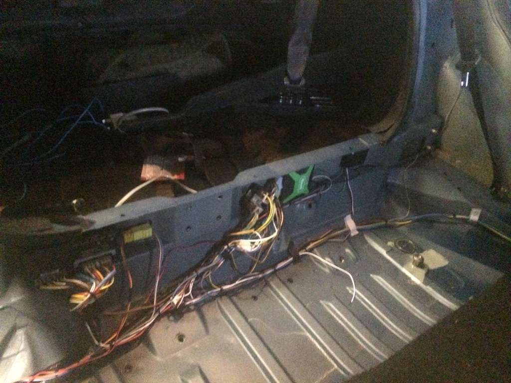

Started into the electrics end of things last night, namely, blowers, heated rear screen and central locking. Turns out one of the connectors in the back of the fuse box was loose, so plugged it in properly, that got the heated screen working. The blowers issue was caused by a melted relay, so GONNA replace that.

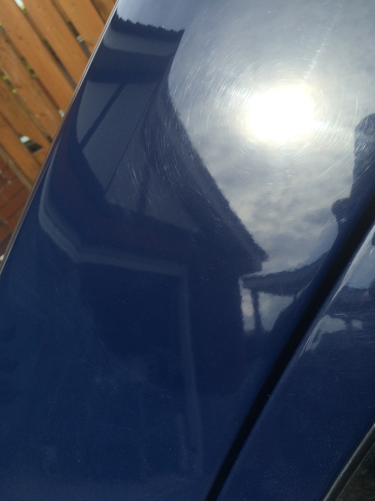

Finally, just wanted to test to see what a quick polish would do with bringing up the paint on the car, it should come up nicely. Car was owned previously by farmers who have clearly washed it with Brillo pads, but came up quite nicely with a bit of polish. Going to give it a proper go over with compound at some point!

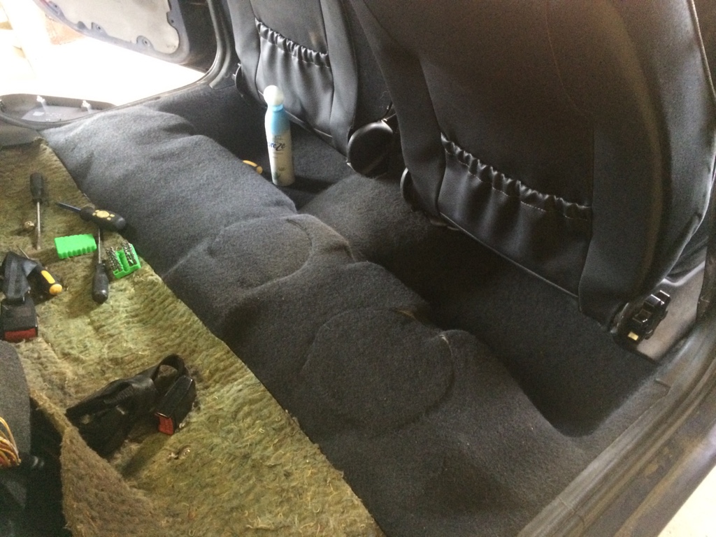

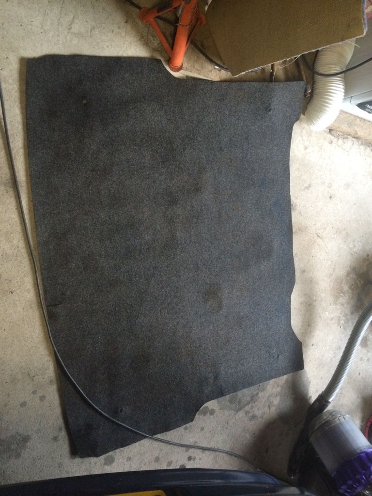

Tonight my girlfriend Clarice was kind enough to offer her hoovering services on the car whilst I removed the door cards, used to be a farm car so was not an easy task, the car stank and you felt dirty sitting in it. Now it's pristine, just how I like it!
[attachment=24208]
Nice little before and after of the boot carpet!
[attachment=24209]

The front and back clean
[attachment=24211]
And the boot finished, then febreezed just to help with the smell. Now just to decide what to do next...

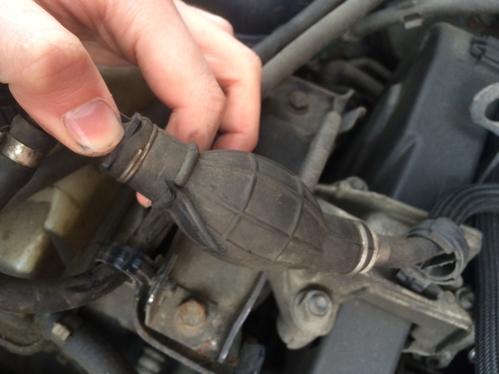

So the sedan has started to be a bit of a pain to start, takes a bit of loving with the accelerator and leaving her to heat properly. So I did the checks for potential air leaks into the fuel, and found this:
[attachment=24237]
Turns out the primer has been rubbing on the part shown in this picture:
[attachment=24238]
So now another thing to the list, new grenade and also looking into inline filters to reduce the chance of air getting in. Also have to fit the new glow plugs which I've had sitting for a few weeks, just need to get round to fitting them!

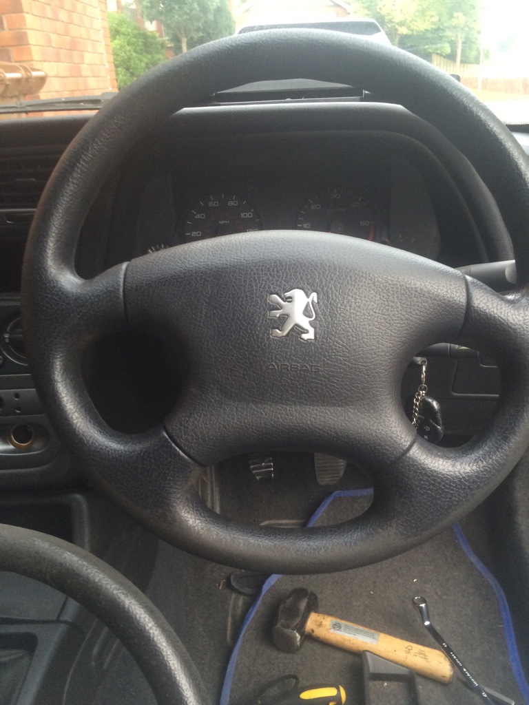

More progress made tonight, a few more things off the list, namely changed the steering wheel...
Before:
[attachment=24501]
And thankfully after:
[attachment=24502]
Much nicer looking, also fixed up all the fascia, still need to find an HDI fascia for the blower part as it has AC to match the rest, one black section in the middle. Tested the speakers Id fitted last night, work a treat, left one is crackling a bit as is the rear right one so going to have to investigate and sort that out. Paid soon so hopefully my list will have a few more things completed in the next month...

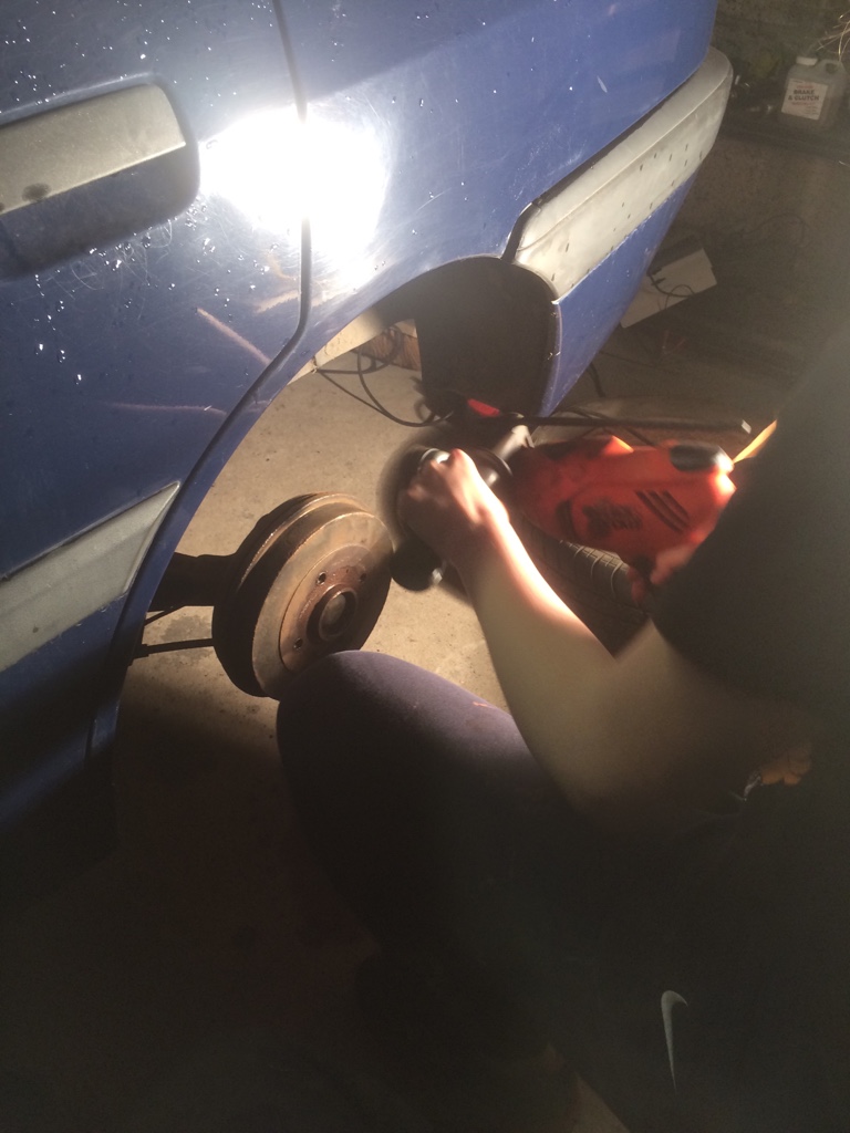

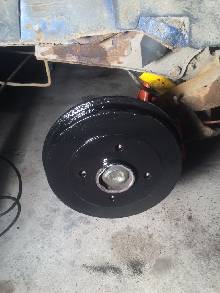

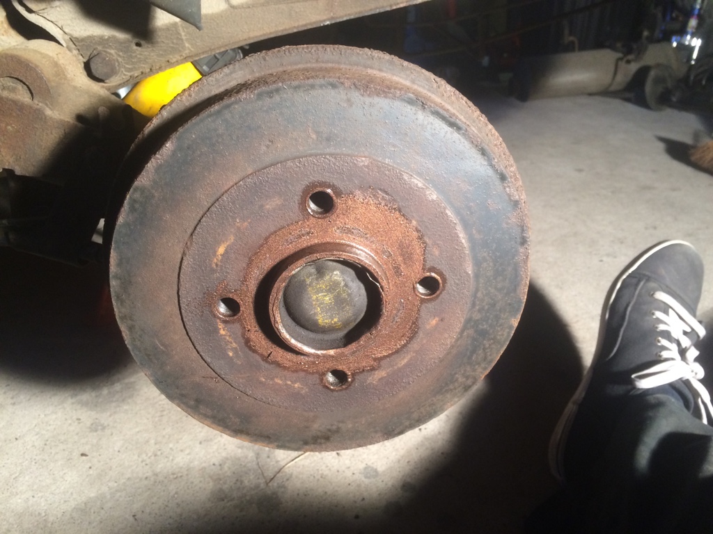

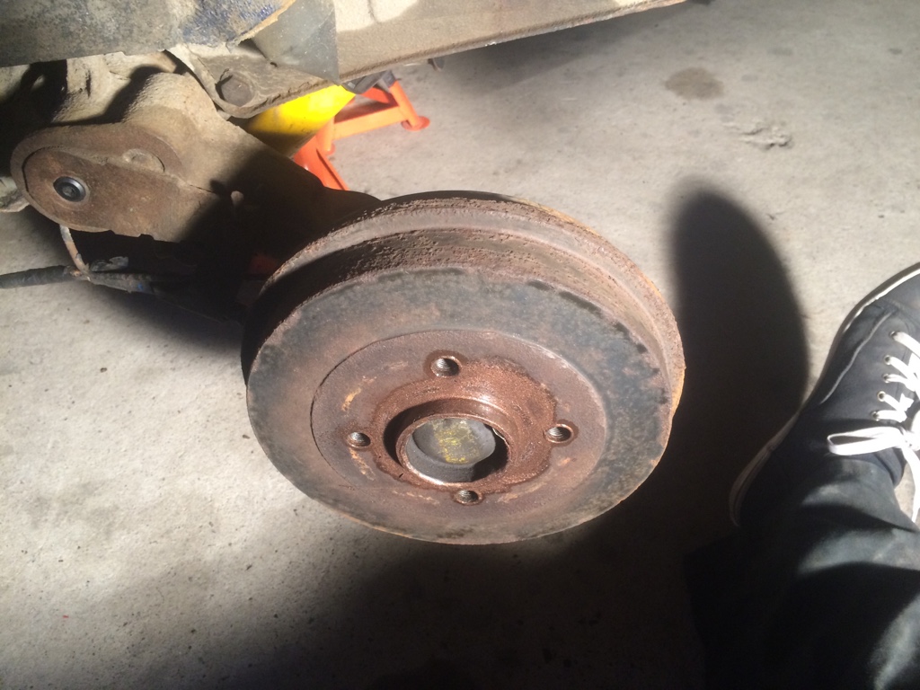

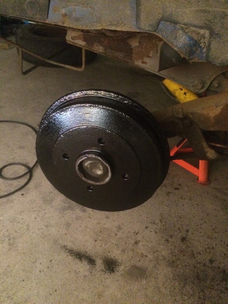

A little more progress today, more just cosmetic shit. Painted the rear drums with the help from said girlfriend Clarice. I cleaned them up and she painted them basically, handbrake stills works fine so saw no reason to replace the drums when I can clean and paint for free!
Started out rougher than this, but you get the idea:
[attachment=24597]
[attachment=24598]
Then Clarice wanted a go at cleaning them:
[attachment=24599]
Then the finished product:
[attachment=24600]
[attachment=24601]
I think they look far better, bit of TLC just. Now I just have to do the front calipers to match! Also buying more suspensions parts etc this week, getting her a few steps closer to being on the road.
Id be pulling the drum off anyway to check the shoes and cylinders. Often get forgotten about
Looking good mate
When I had ta's I could understand why there made the rear shock small that the standard ones.
Planning to do the brakes properly another day, need to get a socket to fit the hub nut on the rear just! Was only doing a clean up job till I can buy the parts.

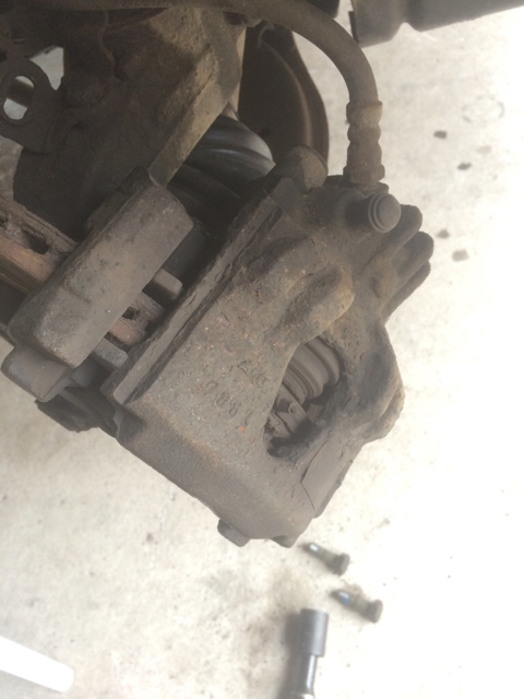

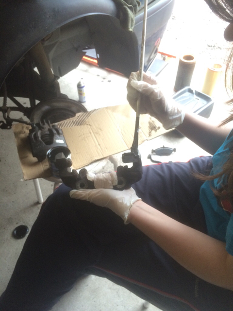

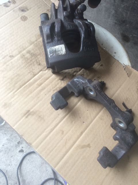

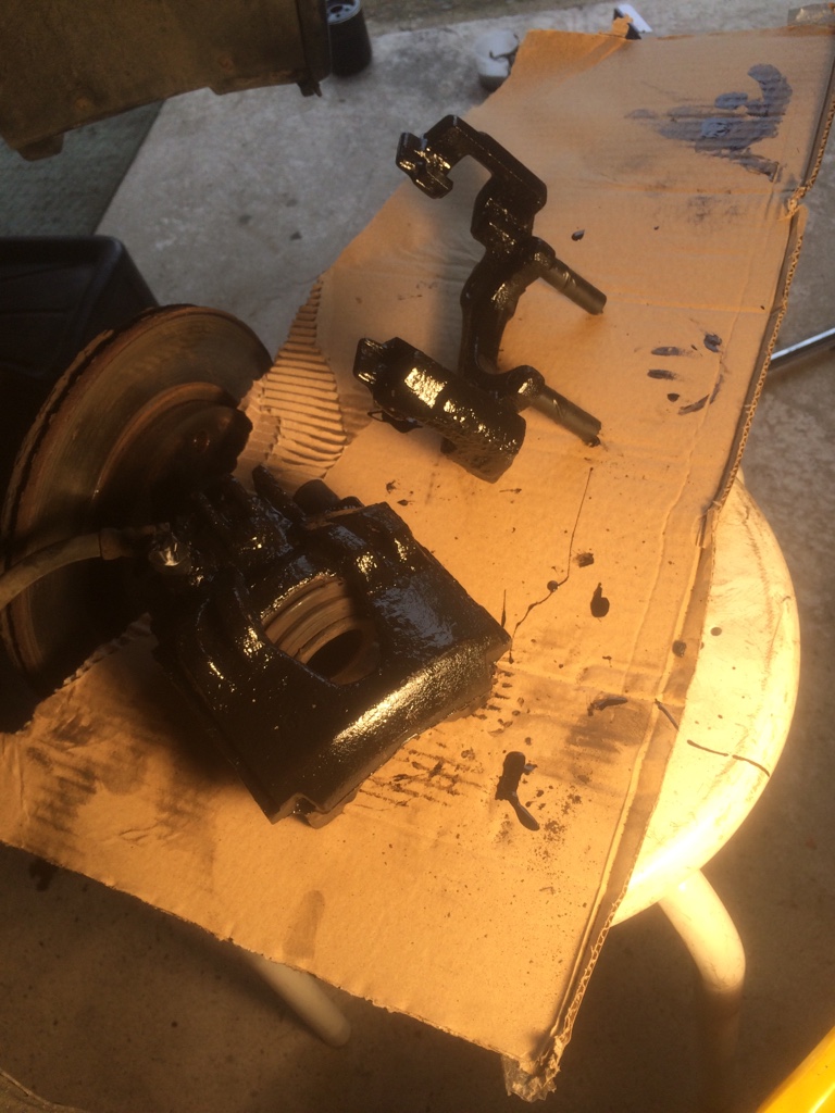

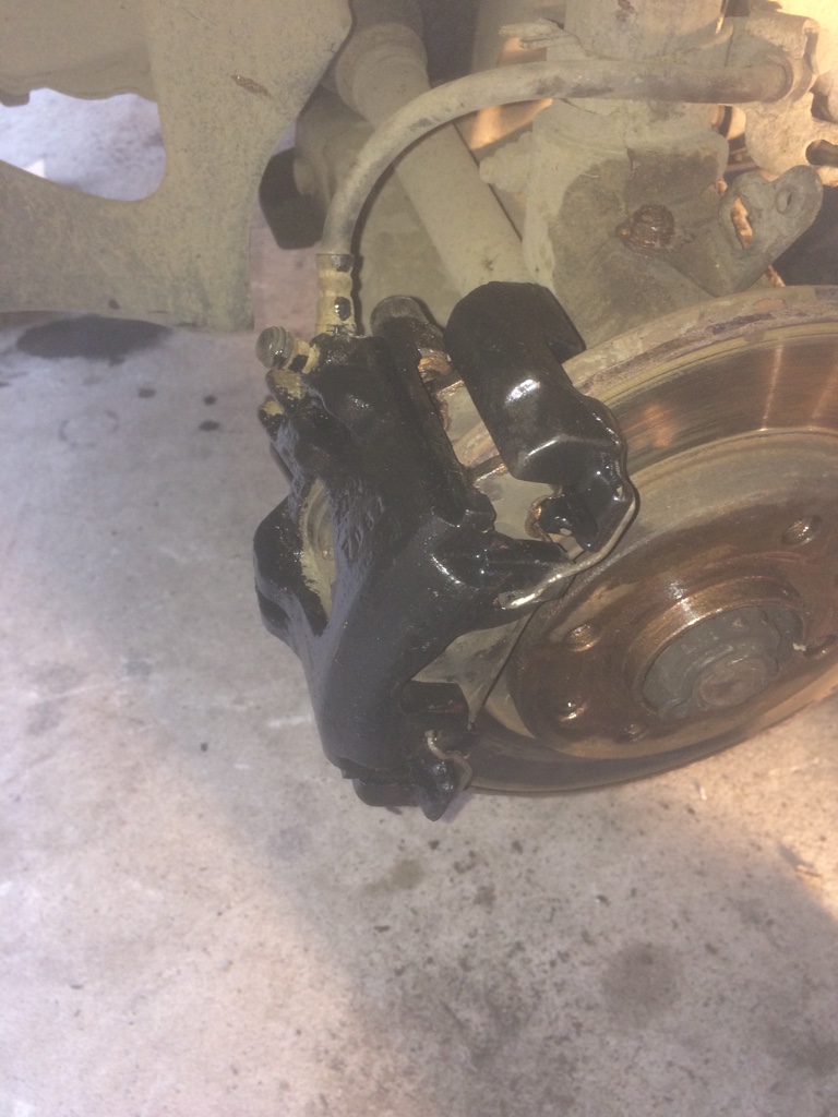

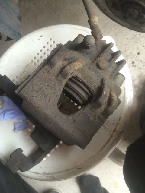

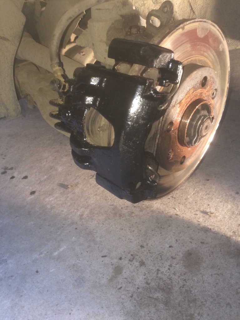

So spent today painting the front calipers, again with the help from Clarice. Gave me a good chance to clean and grease the sliders too.
Before cleaning:
[attachment=24605]
[attachment=24606]
After cleaning:
[attachment=24607]
During:
[attachment=24608]
Used my work light to help dry the paint quicker:
[attachment=24609]
And the finished product:
[attachment=24610]
[attachment=24611]
[attachment=24612]

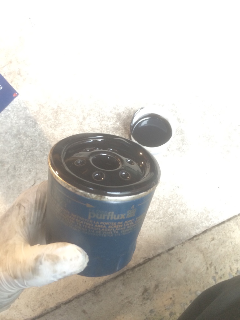

Took the chance at the same time while I was waiting for the paint to dry to change the oil and filter, what came out was vile, so thankfully she's now got a load of fresh oil in. Starts and revs much better.
[attachment=24613]
The thick tar that came out...

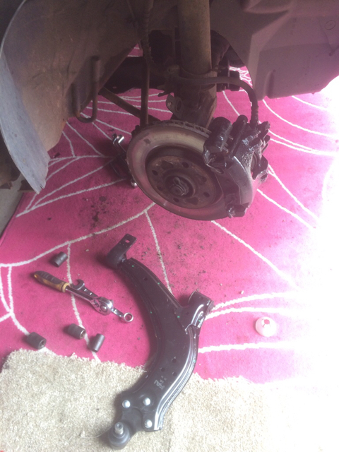

So yesterday was a busy day, changed out both wishbones, fitted new glow plugs, air filter and also changed to an inline fuel filter. Car starts and runs beautifully now!
So you could say that the P bushes were a bit fooked...

[attachment=24631]
So replaced them with nice shiny new ones:
[attachment=24628]
[attachment=24629]
[attachment=24630]
So hopefully no more knocking problems!

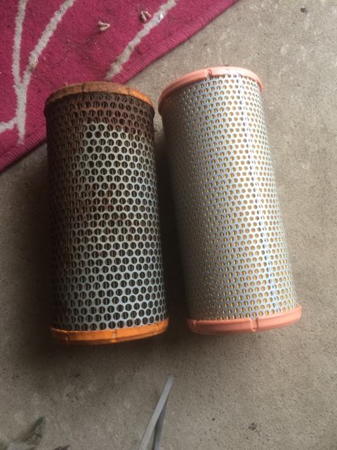

The air filter was in a beautiful state also, just shows you how long it's been since the car was serviced that the whole filter was rusted.
[attachment=24632]
[attachment=24633]

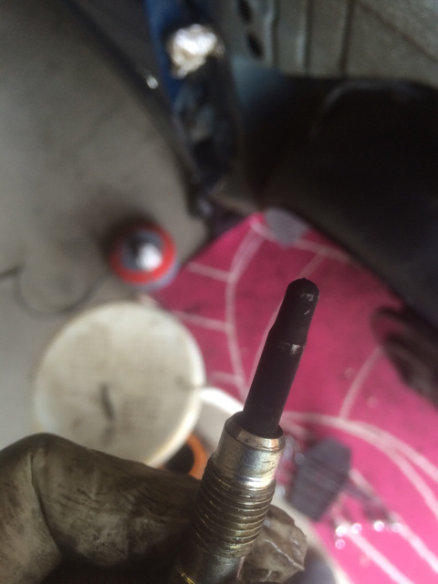

Then went and hit into the glow plugs, I opted to take the intercooler off so I could do the fuel lines too, apparently you can do it without removing the intercooler...
So the glow plugs were a bit passed their use by date:
Old and new:
[attachment=24634]
[attachment=24635]
And yes I was a lazy git and only changed 2, my mate had told me the other too were really awkward to get at, but he did it with the intercooler on...awell. Change the other 2 some other time.
