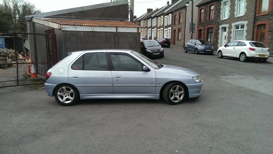

Started off with a stage1 time, no IC and standard gt15. This was an epic build from the offset, I got to poodle and Jonny's house on Friday morning, and it continued through the evening until 11pm Sunday.
The car is as such now.
