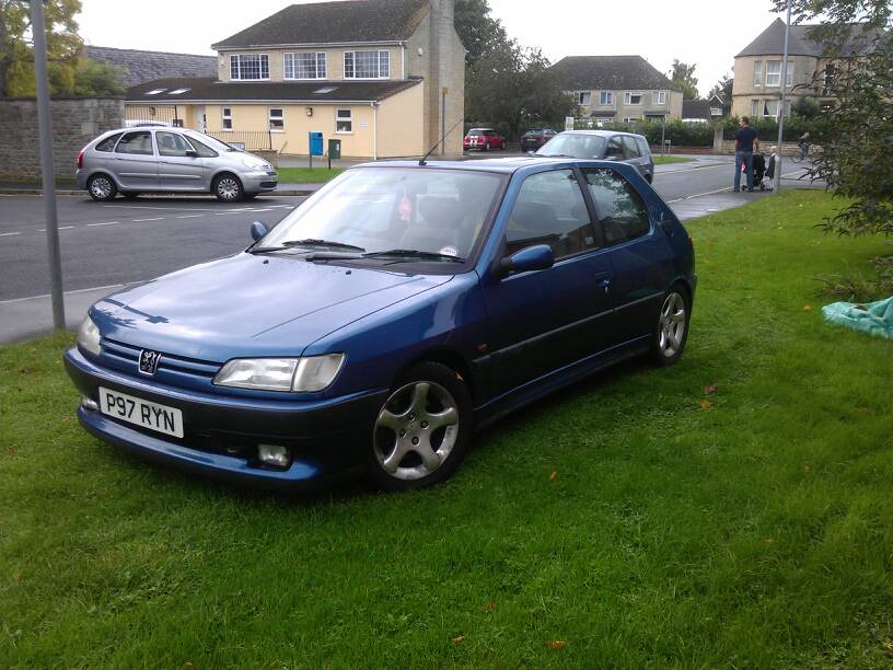

Here's how she's sitting after a bit of use. Going to let the front settle for a bit longer but may end up raising the rear by 5mm to get a bit of rake

Next plans are to paint the inner arches and fit 21mm torsion bars Cool

front end needs more lows, the rear is spot on
Hmmm maybe, still got a pair of spax coilovers but need to get them to spax for a rebuild Dodgy
Looks really smart. Nice height to! I think I need to raise mine as it's to low really
cant you just but a rebuild kit? are they the rsx or somthing like that?
